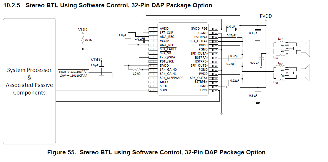

Actually the Stereo BTL Using Software Control, 32-Pin DAP Package Option Typical Application on reference manual have some misunderstood thing.

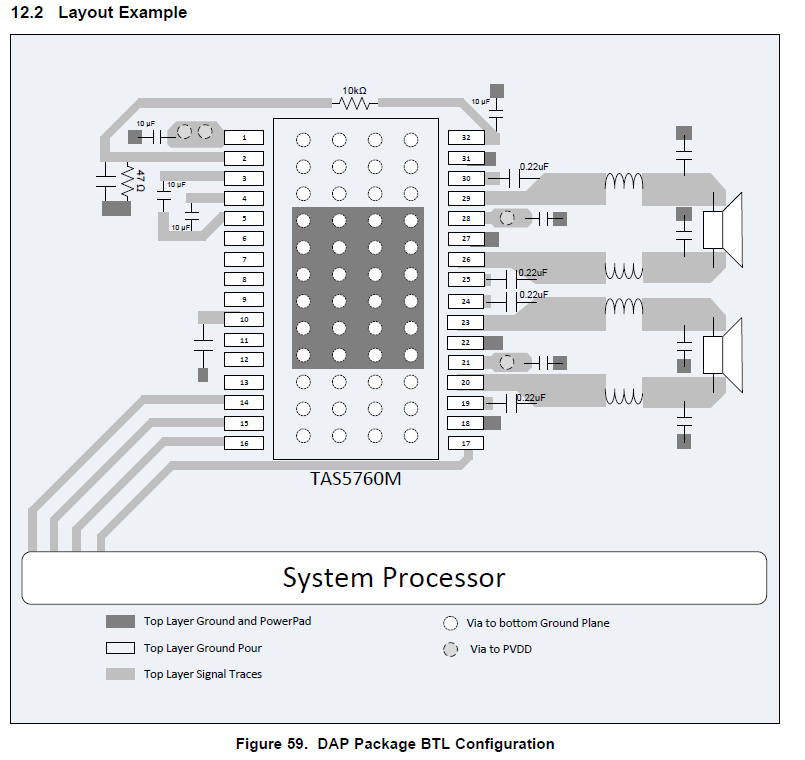

    1) There are pins on the above print screen (Figure 55) that has as reference pin number 46,47,48 in a 32 pin chip.
    2)There are noticeable differences between the recommended schematic and the recommended layout, exist on page 69:
    Misunderstood:
    • Many of the capacitors are in differ on value(Ex. cap. on the pin 1 is 10uF against 1uF as the schematic)
    • There are extra components (Ex.Pull up resistor 10K between pin 2 and pin 32)
    Please tell me which build recommendation I have to follow and what should beware of.

    About your comments, the schematic from the typical application section depicts the usage of the TAS5760M in SW mode with Stereo output. The IC shown in the schematic is based on the 48-pin drawing, so we need to fix the numbering, sorry for he confusion.
    The capacitor in pin 32 is used as decoupling capacitor for the voltage in the gate drive voltage regulator, and the recommended value is 1µF.
    The extra resistors you mention are related to the usage of Soft clip function in HW mode. The resistors from the layout example are used to select the voltage in SFT_CLIP pin. In SW mode, you don't need them as you can use the digital clipper instead of the soft clip feature.

    Thanks for the information, I have reviewed your PCB and schematic, please take a look to my comments.
    Schematic:
    • Can you please share the values of the LC filter components?,
    • You have two inductors for each half bridge output, I guess this have debugging purposes and you use only one in your board, can you confirm?
    • Although it is not showcased in the typical application diagram, it is recommended to put a 0.1µF cap as close as possible in AVDD pin to decouple possible noises from PVDD.
    Layout:
    • First of all, your design is done in 1-layer PCB. It is recommended to use a higher layer count PCB to provide more heat sinking capability for the TAS5760M device and to prevent traces and copper signal and power planes from breaking up the contiguous copper on the top and bottom layer.
    • The 0.1µF decoupling capacitors are located pretty far from the amplifier and after a couple jumper wires, so the decoupling effect is nullified. Not having the decoupling capacitors close to the amplifier will cause ringing on the output pins that can cause the voltage on the output pin to exceed the maximum allowable ratings, damaging the device.
    • You may be able to improve the thermal design, by moving the components on the top and bottom of the amplifier closer to the PVDD pins, so you shall get a clear path from the IC to the cooper plane.
    • Can you please confirm if the thermal pad of the amplifier is soldered to the board?
    • +3V3 connection point is mislabeled as +15V in the layout file
    About the I²S signals, SCLK to LRCK frequency seems a little different from the 64×Fs value, but I think it is fine (32×Fs). MCLK to LRCK rate should be fine as long as MCLK frequency is 128×Fs.
    The latching error you mentioned earlier is probably caused by the high temperature on the IC.Several factors affect the thermal performance of the IC, there is no ground layer acting as heat sink and the heat flow from the IC does not have a clear path through the edge of the board.

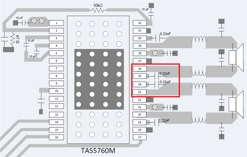

  • Hi Marios-san,
    It seems that your schematic is incorrect since each pair of "SPK_OUTB-(23 pin) and BSTRPB-(24 pin)" and "BSTRPA-(25 pin) and SPK_OUTA-(26 pin)" is swapped in the BTL configuration.
    Please refer to the following layout and doublecheck your board.
    Kato
