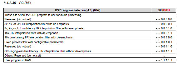

    Ok, I see… so you’re using your own hardware… got it.. Did you already write P0-R43 to 00011111?

    About your question, you may try configuring register 43 (0x2B) with a value of 0x1F to configure the amplifier to use the DSP program loaded in the RAM.

    As far as writing register 43 to 0x1F, we had tried that with no success.
    I did check the file I posted and it didn't have it in that file.  I have tried manually adding a write to that register at the end of register dump, and also tried changing it in the page 0 section at the end of the header file.
    Some of the .h files we have dumped from Pure Path have this register value set, and some to not.  Not sure why it isn't consistent.

    Sorry for the delay. After a couple tests, I found out that your code does not have the HF1 loaded.I managed to test your file in my EVM by changing the C format to CFG, and verified that only the volume can be changed and HF1 had no effect. While working with your XML file, I performed a new register dump after loading your HybridFlow, and it worked as expected in both .CFG and .H generated files. I compared your code with mine, and it seems that your code was dumped before loading the HybridFlow to the amplifier. The dump feature of PPC exports the register settings inside the amplifier, so if you don't load the HybridFlow into the amplifier, the generated code will contain the default processing.

    The header file adds a Post-Initialization section. When I compare this section to your "Exit SD" section, I see that you first call up page 0 {0x00, 0x00}. This was done in the Post-Initialization section just 5 commands before, so I don't see that this is necessary. Then you "un-mute" both channels {0x03, 0x00} which was also done in the post-initialization section. Skip your 3rd command for a minute. After this you take the amp out of powerdown and standby states {0x02, 0x00}, which is also done in the post-initialization. Finally, you set the volume (0x3d and 0x3e). I suspect that this would default to the default value 0x30.
    Back to your 3rd command, which assigns DAC outputA to channel A and DAC B to channel B. This is crucial, because when the hybridflow is stopped (as it must be to create a dump) it sets register 0x2a to 00. This sets both DACs to zero data (mute) ! So there is no data coming out of the mini-DSP.
    Apart from setting the volume level in your "Exit SD" code, assigning the DAC state is the only command that is not duplicated in the Post-Initialization section of the dump file. If my analysis is correct, I suggest that TI strongly consider adding this command to the postinitialization section of the dump file.
