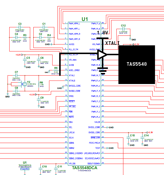

Is it possible to share an external crystal in order to synchronize two TAS5548s and decrease the external components as below ?

Hi Mike-san,
Thank you for your quick response.
Do you have results of that your customers have adopted this method ?
Kato
Hi Kato-san,
I have experience with this "technique", not this specific device. In the past, the devices I've used have either been designed to allow this type of operation ("crystal" or "clock" input on the same pin) or through working with the manufacturer of the device verified that the input can be "over-driven" by a clock pulse as opposed to using a crystal. It should be an easy thing to test; as I say, use a buffer with high output current. For instance, this device should do it:

Hi Kato-san,
You'll want to use the "output" side of the circuit, pin 12.
