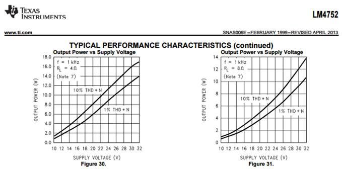

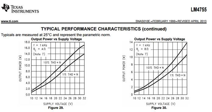

Could you help to find an amplifier of AB class that the output up to 10W.

You could take a look at LM4752 or LM4755.
I hope this helps. Let me know if you have further questions.
-Ivan Salazar

Could you please provide these two IC (LM4752 and LM4755) output power at 12V input?
http://www.ti.com/lit/ds/symlink/lm4752.pdf
http://www.ti.com/lit/ds/symlink/lm4755.pdf
As figure below, only 2.x W??
We need IC can support over 6W when input power only 12V.
Then we can achieve 85db when use 4ohm 5W speaker

I think LM4950 could fit in here.
According to figures 22 and 31 from the datasheet this device should be able to reach the required output level at 12V.
-Ivan Salazar
