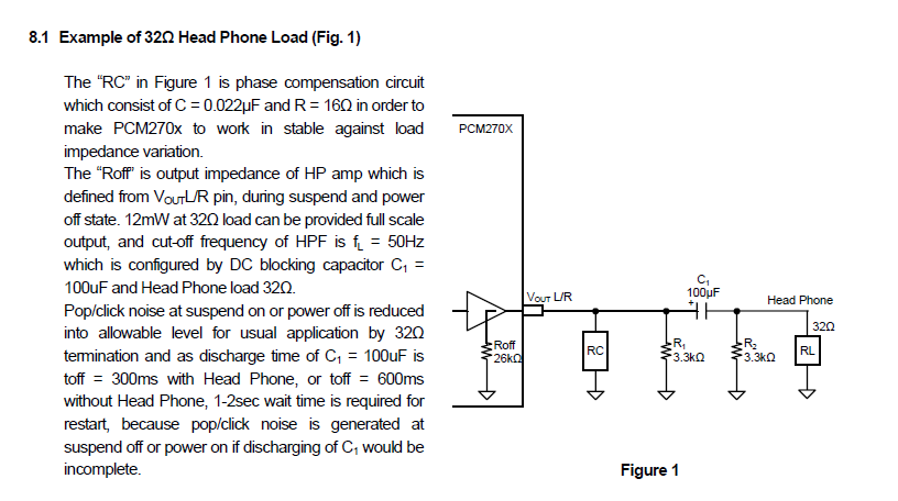

I use USB I/F Audio codec PCM2912A.
There is pop noise when power on/off and load OS driver.
OS: Win7_64bit
CPU: Intel Broadwell-DE D-1559
Could you provide de-pop solution?

Hi Nat,
There is an application note that could be useful on this. Take a look at section 8 of the following document:
Application_Note_USB_090513.pdf
I hope this helps.
-Ivan Salazar
Texas Instruments
Dear Ivan
Thank you for your suggestion.
I also see the pop noise at EVM board(www.ti.com/.../dem-pcm2912aevm).
Could you suggest a mute circuitry to let me follow (at the output triggered by loss of data on the USB port)?
