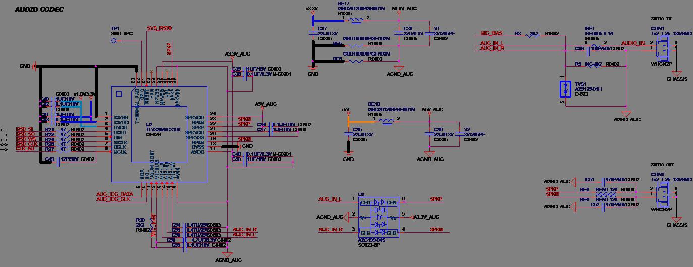

Team,
My customer who use TLV320AIC3100 for their new design, they have used TLV320AIC3101 in their old version product.
But, they found TLV320AIC3100 performance has a gap from TLV320AIC3101 as following list.
  • White noise is bigger in high gain range.
  • AGC(Automatic Gain Control) modulation speed is too slow, and will have pop noise.
  • high frequency(>50KHz) response has distortion.
attachment is register setting, please check whether HW or FW problem that cause this issue.

  • Hi, Marco,
    Regarding your noise issue, I suggest to take a look at the following wiki article. It contains all the possible causes of noise in the boards.
    https://e2e.ti.com/support/data_converters/audio_converters/w/design_notes/3377.common-noise-issues-in-codecs
    I noticed that the thermal pad is connected to the digital GND. We recommend to route this pad to AGND in order to decrease the noise issues.
    Then, regarding the automatic gain control, in order to avoid pop issues, we suggest to configure it before enable any ADC/DAC. Also, the outputs should be disabled while the AGC is being powered on.
    Additionally, could you provide the clock frequencies values (MCLK, BCLK, WCLK)? This is verify if the software is related with this.
    Finally, this codec works correctly in the audible range. So, the frequencies above 50KHz will be decreased. Could you tell me why you're using high frequencies?
    Thank you.
