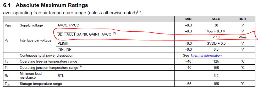

I would like to ask you a question about "Max slew rate" of SD(1pin) and FAULT(2pin).
In case of using 5V not PVCC to control both terminals, we have also to consider the "max slew rate 10V/ms", right?
Thank you and Best Regards,
