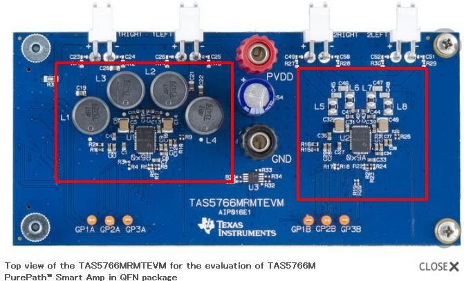

I would like to confirm components of TAS5766MRMTEVM.
It looks like that components are different between Ach and Bch.
Could you tell me why these are different?

Hi Kuramochi,
The device on the left is using a LC filter while the one on the right is using a ferrite bead output filter.
Below is what we mention on Page 48 Of the TAS5766 datasheet.
The TAS576xM can be used with a small, inexpensive ferrite bead output filter when speaker are placed with
short internal wires and supply voltages are 12 V or lower, for systems with longer wires or higher than 12V
supply voltage LC filtering is recommended.
