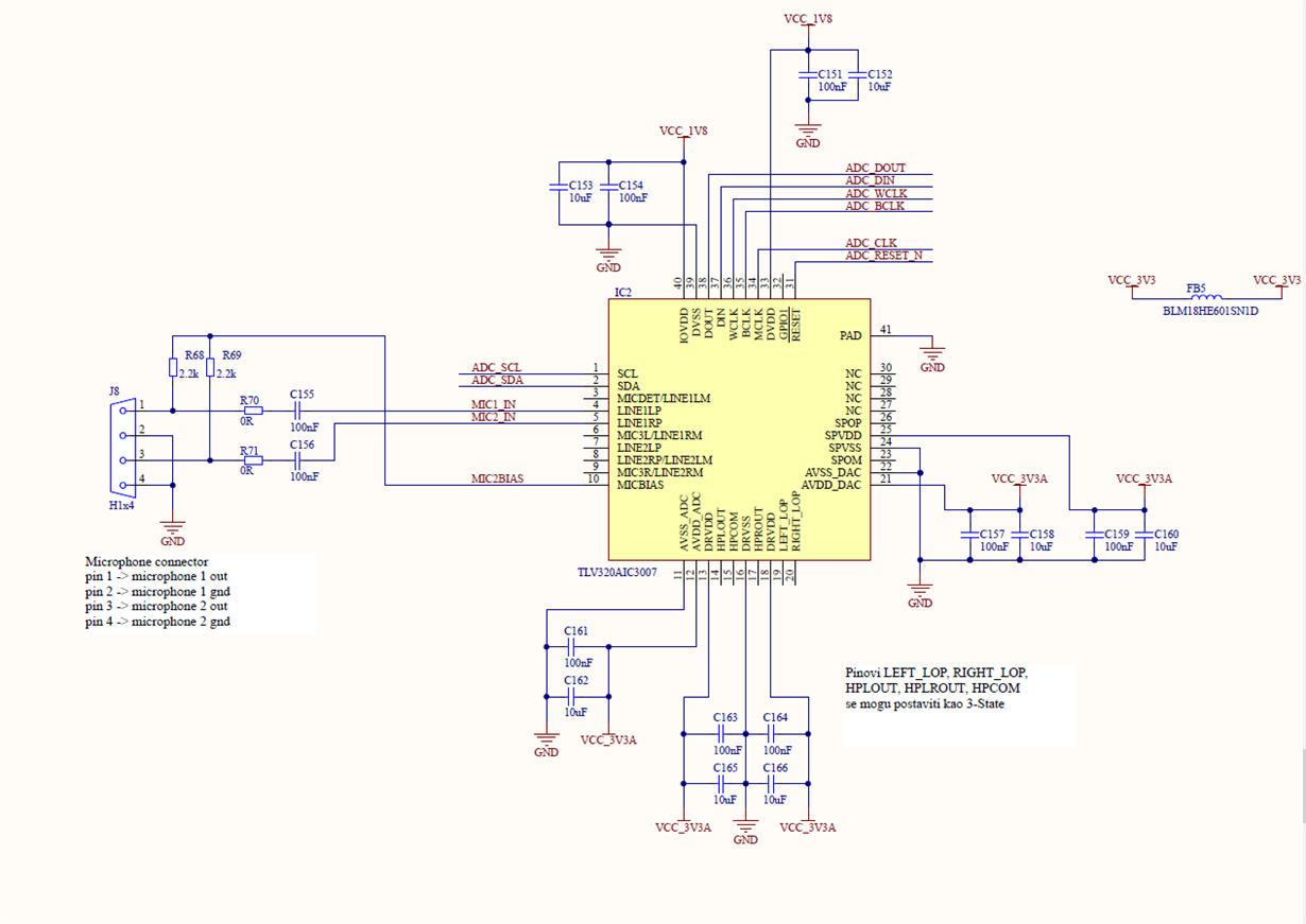

    I think I also need a way to configure microphone bias.
    The datasheet says Page 0 / Register 25 controls that, so I assume something like this would do the trick:
    w 30 19 40
    On the PCB I will have (it should arrive in a week or two) LINE1LP, LINE1RP and MICBIAS connected, and I need to get I2S output.
    The snapshot bellow shows the schematic:
  • Hi, Stepan,
    Your schematic is in order. I didn't find any change to do.
    Also, regarding the MICBIAS configuration, you're right. This is enabled with the Page 0 / Register 25. You should remember that this configuration is for differential input. If you're looking for single-ended configuration, you should modify registers related with LINE1L/R routing.
    Luis Fernando Rodríguez S.
  • Hi Luis,
    Ok, yes it is a single-ended configuration.
    Thank you very much,
    Stjepan Henc.
