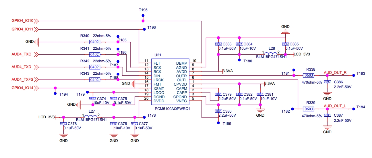

My customer used PCM5100A in the automotive cluster, during debug we found the PCM5100A abnormal out the pulse as figure 1, I check the power and I2S input don't find the abnormity. Do you have the suggestion for it? thanks..
Figure 1
Also I modify the C379 and C380 to 4.7uF no improvement this issue. Thansk...
