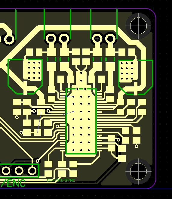

I'm currently designing a PCB based on the TAS5754M with HybridFlow3
-Do I need to pull up the I2C control port lines?
-Are there any other requirements for the I2C host uC besides 5kB flash for the HybridFlow?
-What is the normal procedure for configuration? Can someone walk me through the normal bootup process of the chip, because I'm not sure if I fully understand it. If I understand it correctly you can configure the IC with the I2C from the PPCMB for once, after that the uC just needs to upload the registers at each powerup?
As time goes on I'll probably have some more questions to post here
(resistors in PCM signal are 0R for debugging.
