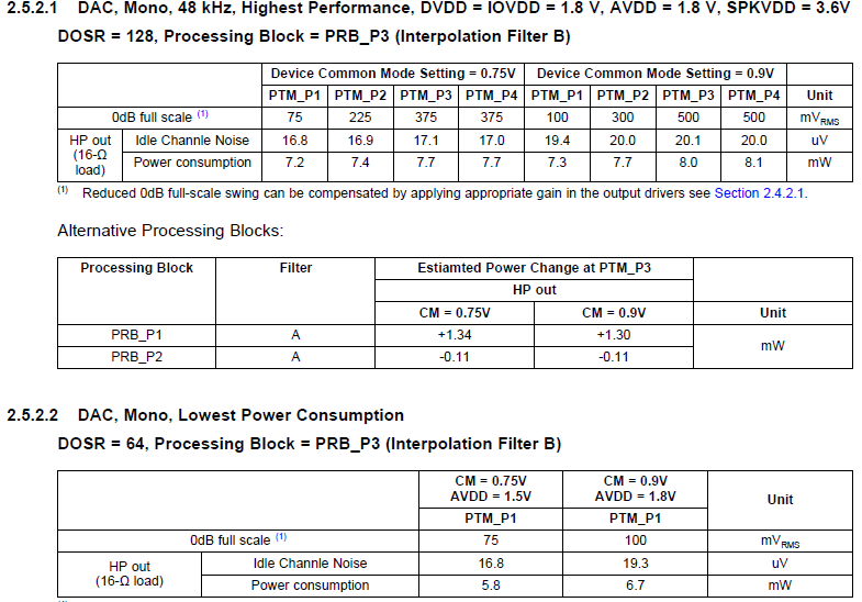

  • Hello Ivan,
    Thank you for reply.
    Regarding to power tune mode in reference guide(page 26-28), I have some questions.
    My customer's power supply and Fs conditions are following.
    SPKVDD  5V
    IOVDD   3.3V
    DVDD    1.8V
    AVDD    1.8V
    Fs      :192kHz
    HP(headphone) Amp : Not use.
    Speaker(8ohm)   :1.4W max
    (QUESTION)
    1. About the DAC Power Consumption(page26),
    I will refer following items but some conditions are different from theirs.
    ・ In case of their condition, how much will the consumption power be?
    (SPKVDD5V, DVDD=AVDD:1.8V, IOVDD3.3V, Fs:192kHz, HP amp: Not use.)
    Or how much will it increase power consumption compared to value of table(page26) ?
    2. About the Speaker output Power Consumption(page28),
    I refer following items but some conditions are different from theirs.
    (A)In case of their condition, how much will the consumption power be?
    (SPKVDD5V, DVDD=AVDD:1.8V, IOVDD3.3V, Fs:192kHzSpeaker:8ohm)
    Or how much will it increase power consumption compared to value of table(page28) ?
    (B) The value of table is measured with condition of no signal input.
    They need power consumption at max power speaker output.(1.4W@8ohm)
    When speaker output is max, how much will the consumption power be?
    Or do you have characteristic of Supply Current vs Output Power? (It's like following.)
