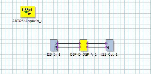

  • hi Luis,
    we were able to configure loop back in the board - meaning we can hear an audio file using our headphones and record it in the same time
    as you can see : we connected I2S In R to MonoInt2xOut_1x , and using the DSP also to I2S out R
    we also want to record on the same time so we tried using : MonoDec4xAGCIn but we couldnt record anything
    we want to know how we can configure the input microphone to go to I2S I/F
    appreciate your help
  • Hi, Eyal,
    First of all, I recommend to replace the MonoDec4xAGCIn_ block by the MonoDec4xIn block. Then, I suggest to ensure that the correct analog input and MICBIAS are configured in the SystemSettingsCode as mentioned above.
    Luis Fernando Rodríguez S.
