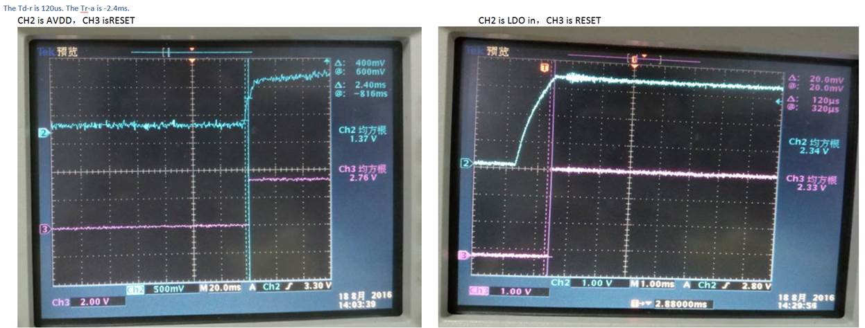

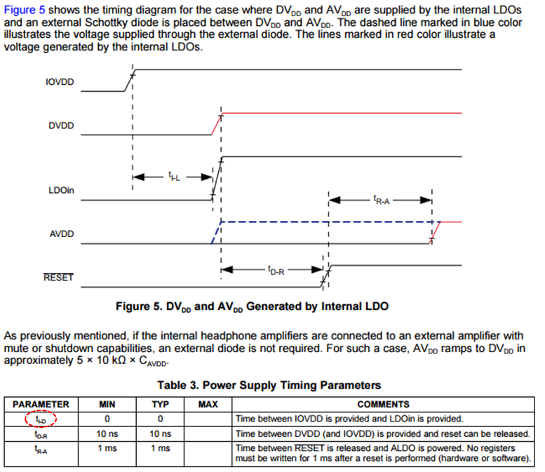

Asking for the AIC3254 power up timing
Hi Team,
Did you provide the T1,T2 and T3 timing?
