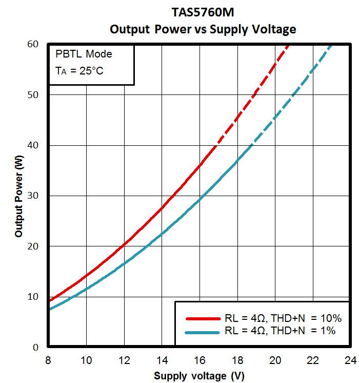

Could you provide output power vs supply voltage graph of mono parallel BTL mode? there is the graph of stereo BTL mode but there is nothing for mono BTL mode.
My customer is currently using TAS5760M and wants to make 30W amp for next project. In the datasheet, there is max continuous output power = 40W with PVDD=24V, Rspk=4ohm. is the spec based on EVM?
