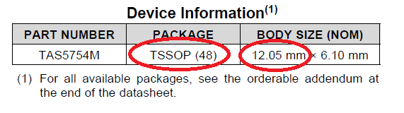

①Page-1
 ・The correct is HTSSOP package and 12.50mm, right?

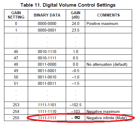

③Page-51
 ・The correct is -103dB, right?

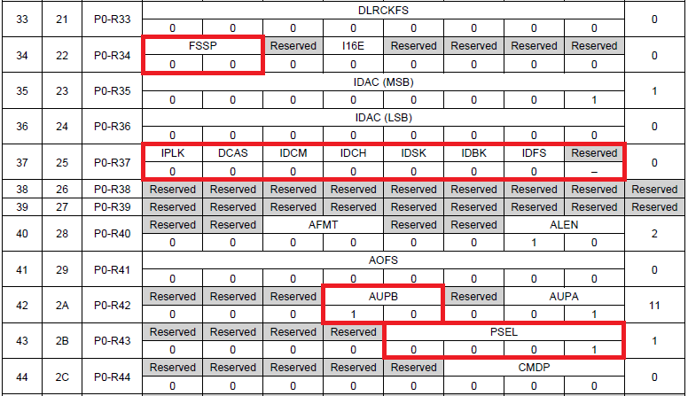

④Page-52
 ・Datasheet page-74 is "reserved", which is correct?
⑤Page-62
 Register Map is differ from Detailed description below, which is correct?
 ・P0-P34(Page-70) is assigned [1:0].
 ・P0-P37(Page-71~72) is assigned 0bit~6bit.
 ・P0-P42(Page-72) is assigned [5:4].
 ・P0-P42(Page-72) default setting is "00000001".
 ・P0-P43(Page-73) is assigned [5:0].

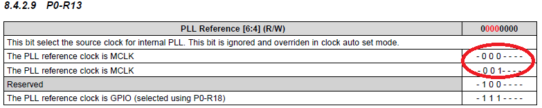

⑥Page-67
 ・Are "000" and "001" both the same clock(MCLK)?
  Or, is it typo?

    1. Yes, correct is HTSSOP and 12.50mm.

    3. Yes, correct is -103dB.
    4. It is Reserved, however, has the same function as mute, but is recommended to use the Mute feature from Register 3.

    6. The second one (001) corresponds to SCLK as PLL reference.
    We are working to update the TAS5754M datasheet, thanks for your contribution.

  • Hi, Satoshi-san,
    Please refer to my findings below:
     ・P0-P34(Page-70) is assigned [1:0]: Correct assignation is [1:0].
     ・P0-P37(Page-71~72) is assigned 0bit~6bit: Correct Assignation is the one in page 71-72.
     ・P0-P42(Page-72) is assigned [5:4]: Correct assignation is [5:4].
     ・P0-P42(Page-72) default setting is "00000001": Correct Default setting is 00010001.
     ・P0-P43(Page-73) is assigned [5:0]: Correct assignation is [4:0].
      -Diego Meléndez López
       Audio Applications Engineer
  • Diego-san
    Thank you for many update.
    I understood correct information.
    Satoshi
