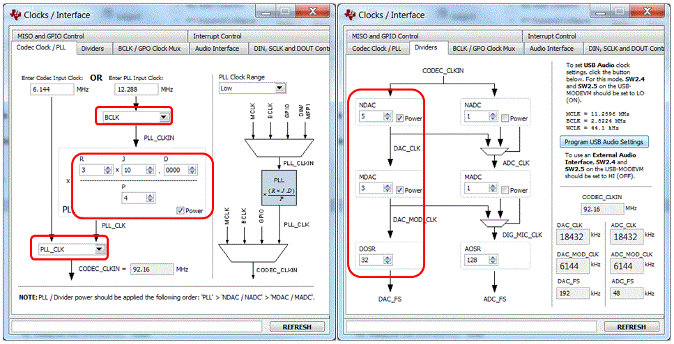

Customer has adopted TLV320DAC3203 headphone amp.
The system does not provide MCK, Noted the DAC clock can be derived from BCK via the PLL.
The supported BCK are 64fs and Fs is in the range of 44.1kHz to 192kHz
Does below settings applicable to support across Fs 44.1k to 192k ?
If not, kindly provide the PLL table. Thanks
