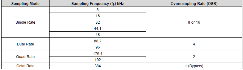

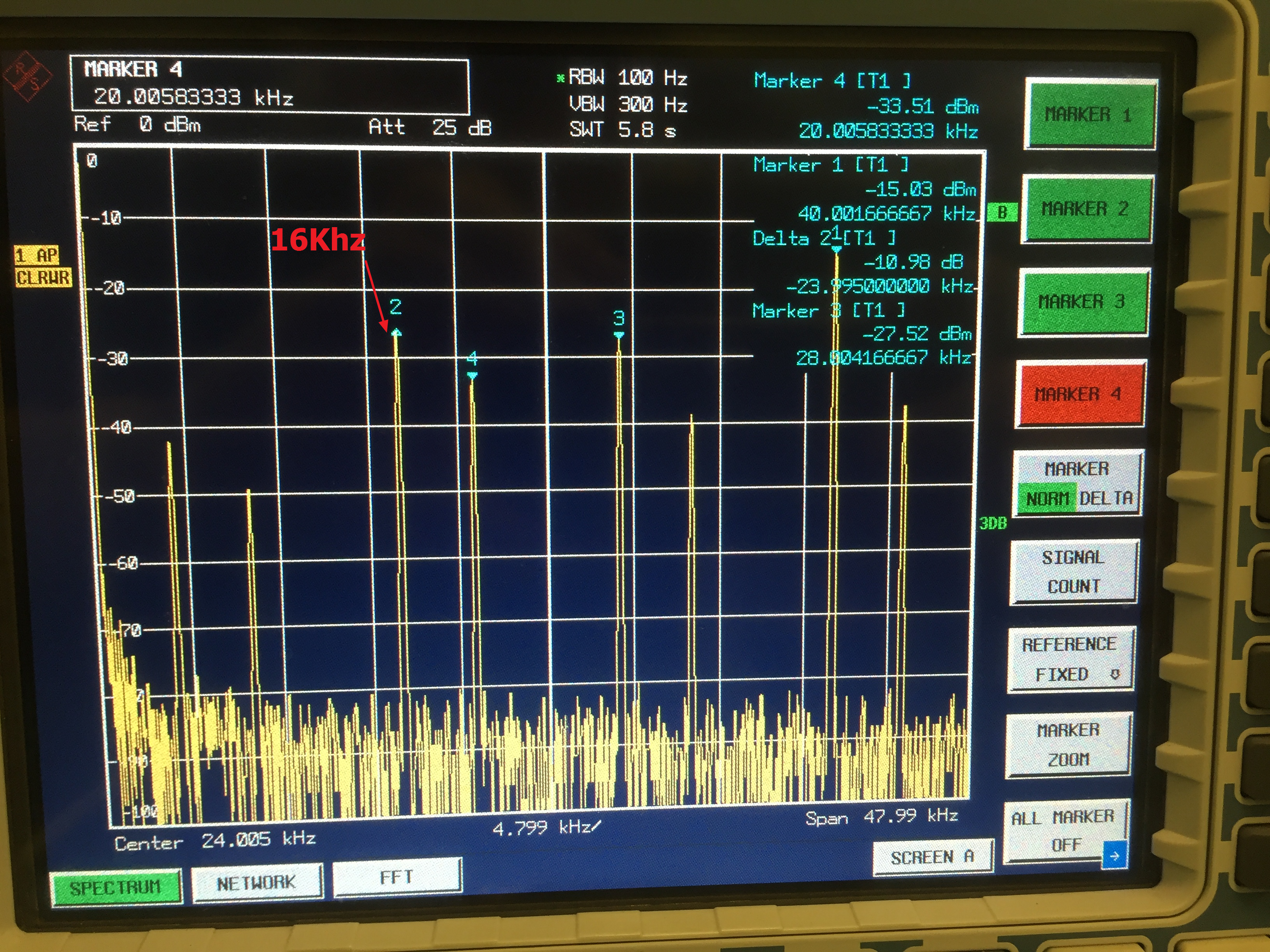

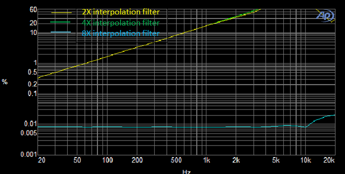

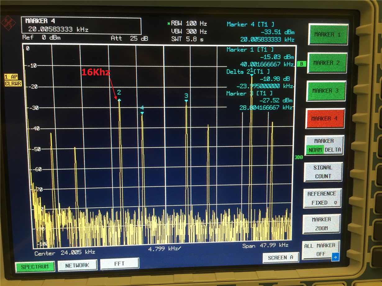

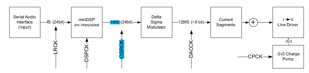

Why must we use 8X ingterpolation at 48K sampling rate in PCM5242 ,if using 4X and 2X ,THD +N  vs frequency is terrible.Testing curve is attached for your reference.do you have any material explaining interpolation filter clearly?
I2S configuration: MCLK=12.288MHZ,SCLK=3.0272Mhz,LRCLK=48kHz
