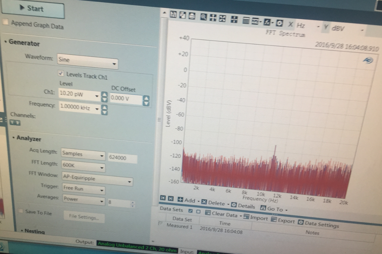

2. If we short the DIN pin of I2S to ground, we can see a 11kHz noise on the output. The same thing also happened on TAS5760EVM shang TAS5756 EVM. If the input signal is not always zero, there's no peak on 11kHz. Could you please let me know why? Thanks.

    2. If we short the Din pin of TAS5760 to ground on our EVM, then connect the EVM to computer with USB cable, open PPC2. After initializing, we can get the FFT graph with 11kHz peak. If remove the short DIN, then 11kHz peak will disappear.

    2 - I followed the procedure you mention and found a similar peak. I also found that this peak is only present when DIN is shorted to GND, after removing the short, the peak disappears. I tested the EVM without shorting DIN with GND before connecting with PC and found there is no peak in the FFT plot. Can you replicate this?. Also, I would like to point out that the 11KHz peak level is under the amplifier's spec.

    2. Yes, I can replicate. Also it is totally the same with my test result. We are curious about why could this happen, even though it is under the ampilfier's spec. Also customer is interested in whether this could cause any potential risk.

    As I mentioned before, configuring the gain of the amplifier as directed in sections 9.4.1.7.1 and 9.4.2.4.1 of the datasheet will help reducing noise level. Basically, you need to configure the amplifier with the lowest gain that allows the user to achieve the desired output power into a determined load. The peak might be caused by noise coupling into the system's ground when shorting DIN to GND. There should be no potential risk as the peak is under the amplifier's noise spec.

    SDIN pin is weak pull down inside TAS5760. If there's low frequency noise such as 11kHz coupling into ground, the noise should have strong drive capacity. Why there's strong drive capacity for the SDIN pin?
