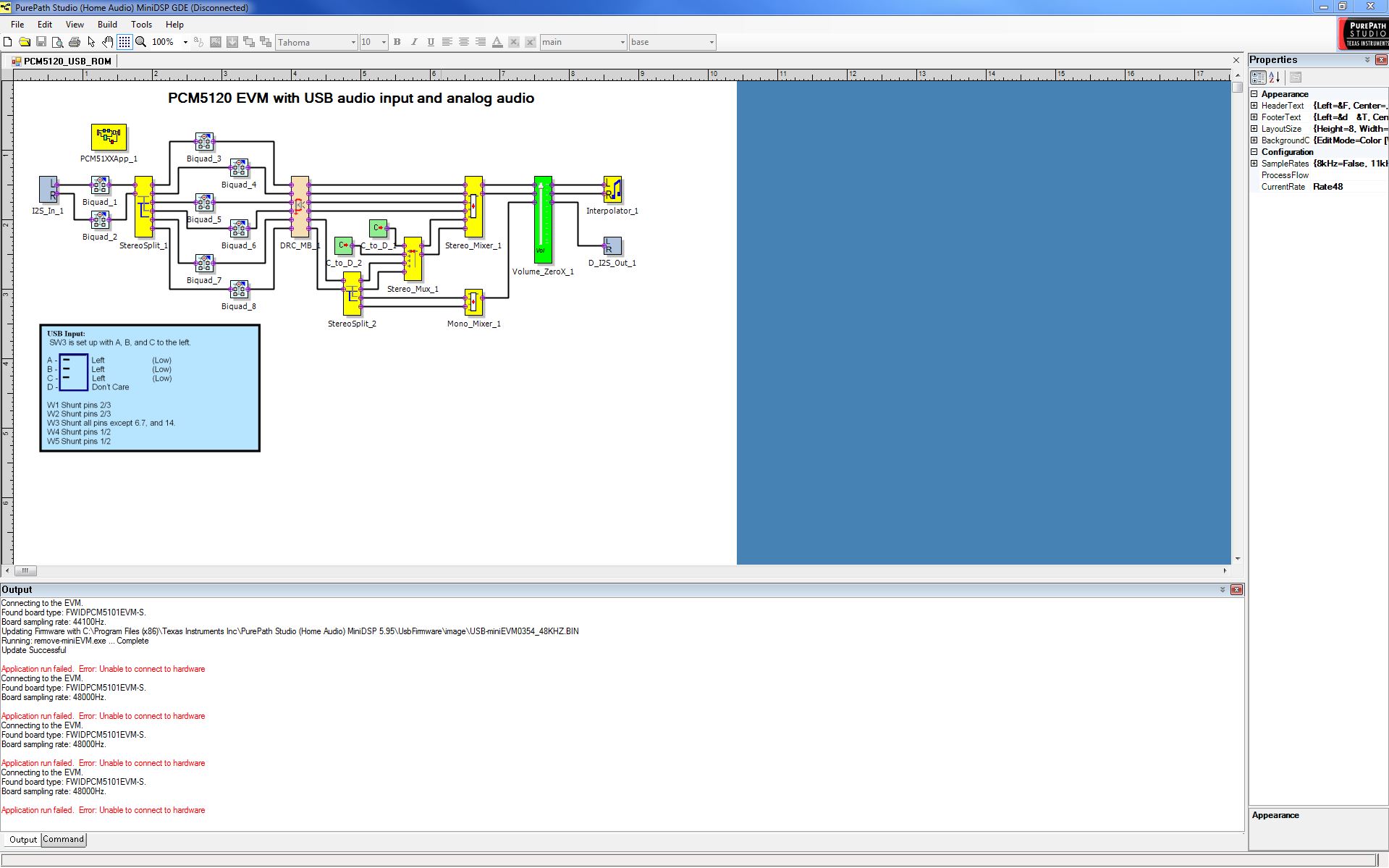

  • Daniel,
    You can achieve USB input to stream audio to the board using Purepath studio GDE along w. setting the SW3 (A,B,C) to LOW. Please refer to section 3.1 in the below linked App note.

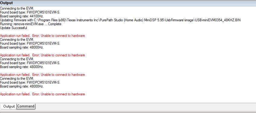

  • I downloaded PurePath Studio Home and installed it. I was able to connect to the EVM enough to update the firmware to 48kHz sampling rate. But I now have connection issues, see attached captures of the errors. I have the jumpers all configured as instructed per manual http://www.ti.com/lit/an/slaa541/slaa541.pdf
    Not sure if I understand the instructions for W3: W3 Shunt all pins except 6.7, and 14.
    Does this translate to except 5 to 6, 7 to 8 and 14-16? In my case, I have all shunts loaded except for pins 13-14.
    Bottom line, is the PCM5122 supposed to be in I2C mode or hardware mode?
  • Ravi,
    Never mind my earlier responses. I figured out the correct set of jumpers. I had to set the address pins of the PCM5122 to GND in order for the I2C to connect to the PCM5122. I see a -3.3V power rail and data on the I2S bus now.
