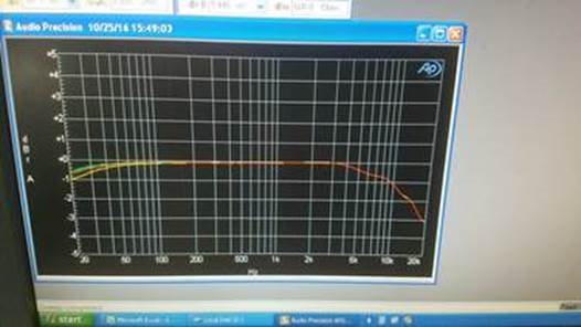

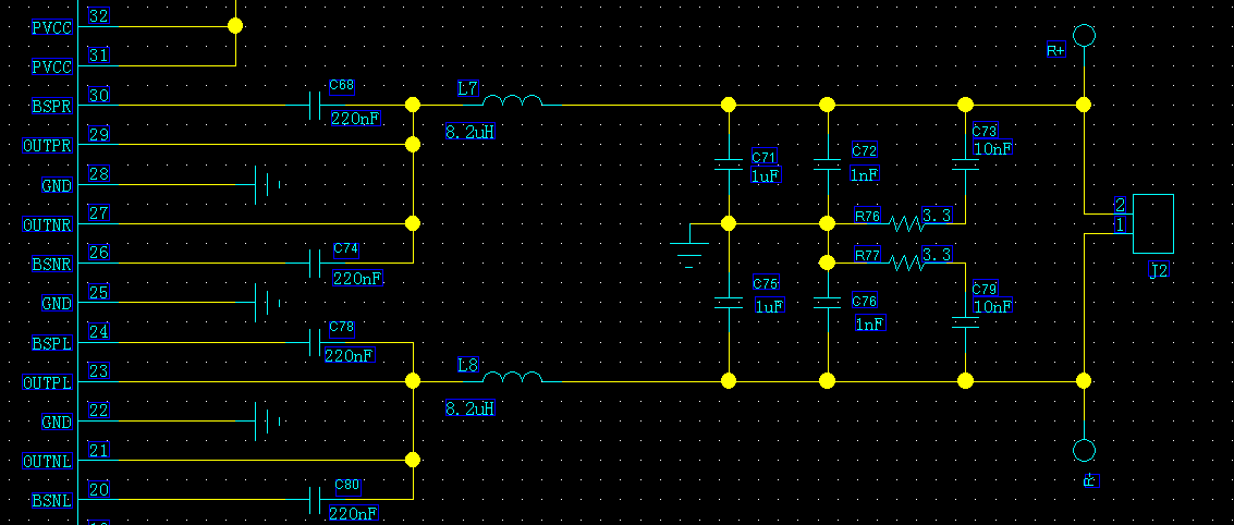

My customer use TPA3118 us a power amplifier,They use PBTL mode,
1. when testing frequency response ,They find that from 7Khz signal begin to attenuate,Their SCH is attached for your reference, I have calculate the cut off frequency, it is 55.58K,which may not have impact to the output signal.
2. In PBTL mode, should we use 4 inductance or only 2?
