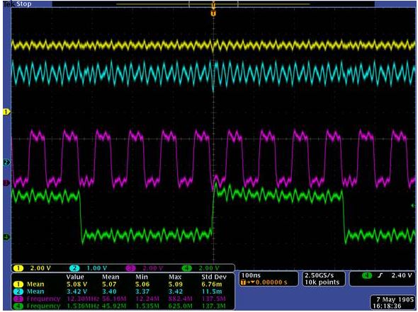

We got the PCM1808 startup problem in slave, I2S mode which needs your suggestion.
Please refer to the schematic and screen capture:
Power Up Sequence (CH1=5V VCC, CH2=3.3V VDD, CH3=MCLK, CH4=BCLK), PCM1808 MD0=MD1=FMT=GND
SOC sends MCLK, BCLK, LRCK only when music playback, the PCM1808' does not send valid Vref (only 1V), the PCM1808 does not send DOUT (always low)
Power Up Sequence: 5V, 3.3V startup earlier than MCLK and BCLK
Music Startup
Music Playback:
