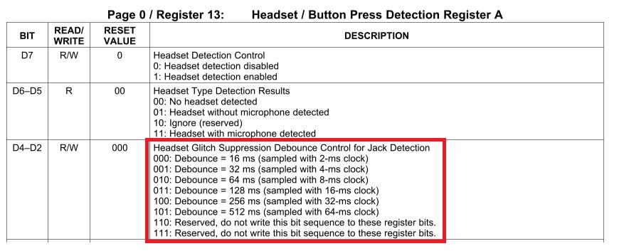

Hello Sirs,
We are testing the 3.5mm jack headset detect function, when we plug in 3.5mm jack, the AIC3106 sometimes cannot identify the accessory with MIC or without MIC.
We tried to configure Register 13 to increase debounce timing from 16ms to 512ms, but still in vain. Would you pls advise possible reason of this problem? Should we switch to the newly TS3A227E jack detection IC?
