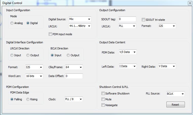

Can you help check how to set the PDM mode for digital micphone for TAS2552?

    TAS2552 does not support digital mic.
    PDM is used to connect TAS2552 to the host in order to transmit the I/V sense data.
