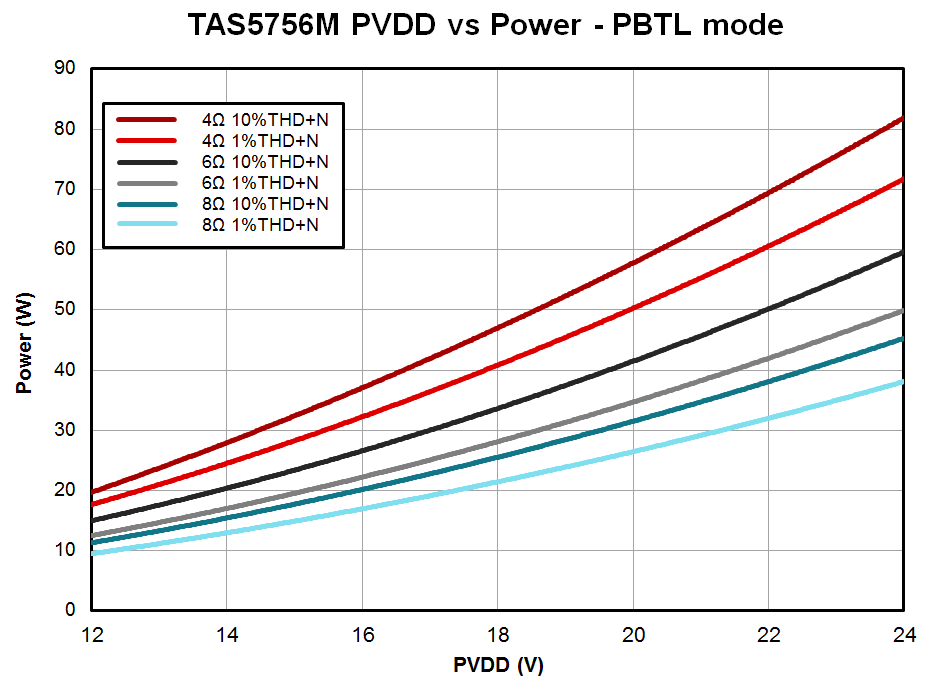

Do you have the data about output power vs PVDD at PBTL with 6ohm load?
If you have it, please share it with us.

Do these plots have any restriction by thermal performance?
The customer expects over 75W@6ohm, 24V with PBTL.
So, TAS5756M can’t achieve the target output.

There is no thermal restriction on the plot I provided. The maximum power the TAS5756M can deliver is limited by the power supply and the current drive of the power stage. PBTL mode offers double current sourcing from the power supply, allowing the use of smaller loads (without thermal or overcurrent issues). Do you know why customer is expecting 75W from 24V power supply into 6 Ohm load?, this assumption seems quite unrealistic.

I'll suggest to reduce the load of speaker to customer, if they want more power.
