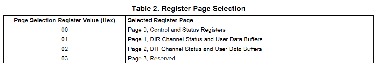

The customer want to transfer data command through S/PDIF. They find register 0x16 has the function of  receiver buffer transfer interrupt, but don't know which register should be used to write and read data.

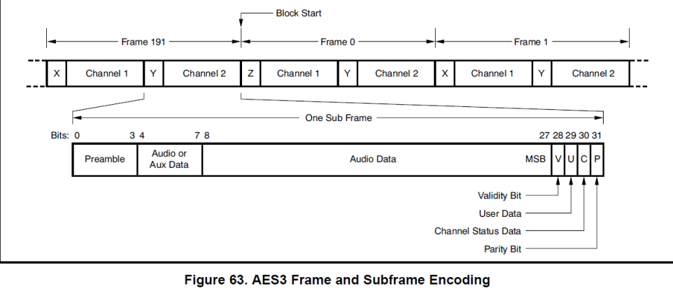

In the datasheet, I find maybe User data bit could be used to transfer the data command. DIR and DIT will be saved in Page 1 and Page 2 respectively. Is that correct?
And would you please provide example code to realize this function? Thank you.

    As mentioned in Register and Data Buffer Organization section, Register Page 2 contains the digital interface transmitter channel status and user data buffers. The contents of these buffers correspond to the data contained in the C and U bits of the transmitted data stream and they may be written through the SPI or I2C serial host interface to configure the C and U bits.

  • Hi, Robin,
    In order to configure this function, it is necessary to configure the following registers:
    Register 08 (Transmitter Control Register 2) / Bit TXBTD should be '1' to allow the user to update DIT C and U data buffers.
    Register 09 (Transmitter Control Register 3) / Bits TXCUS[1:0] should be "01" to update the buffers via SPI or I2C.
    Register Page 02 are used to write the DIT User Data Buffer Map.
    Luis Fernando Rodríguez S.
