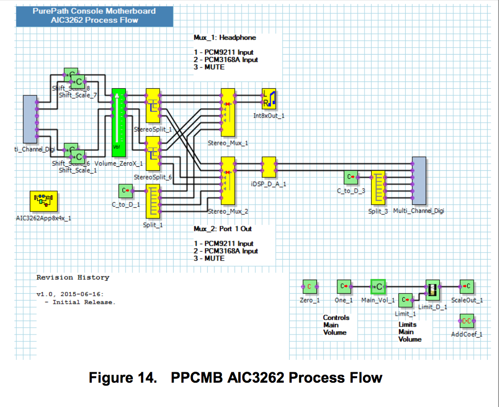

Is the PPCMB_AIC3262 .pfw file, as loaded on the PurePath Console Motherboard (Rev. G), available for download? I would like to make some modifications. I have found a screenshot of the diagram (see below), and the header files in the Self-Boot Easy Demo project. It would save a lot of time to have the Process Flow file.

  • Hi, Alex,
    By default, the PPCMB does not have a pre-configured process flow. The process flow you are showing is the one used n the Self Booting Audio system. This process flow can be found along with the download files for the Self Booting Audio System,
      -Diego Meléndez López

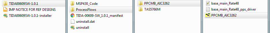

  • Hi, Diego,
    Thank you very much for your quick reply and clarification. The Process Flows folder was outside my search path, opps. I found the file and am making the changes I need now.
    Thanks for your help!
