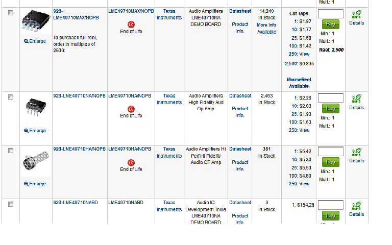

  • Thank you for your prompt reply. Someone needs to contact Mouser because they have the LME49710 as Lifebuy status. I got confused by that, so I ordered some just to be sure.
    Dirk
  • Digikey also has the LME49710 as life time buy.

    After I consulted with the team about the status of LME49710 and LM4562 I got the following information:
    LM4562 - SOIC and PDIP packages are in Active status while TO-99 is being EOL
    LME49710 - Unfortunately this one is EOL for the three packages (SOIC, PDIP and TO-99). It seems that Mouser received the PCN about this and updated the status, while TI site was not updated. Proposed replacement is OPA1611.
    TI product folders for these devices show the correct status now. I am very sorry about all the confusion generated because of this.
