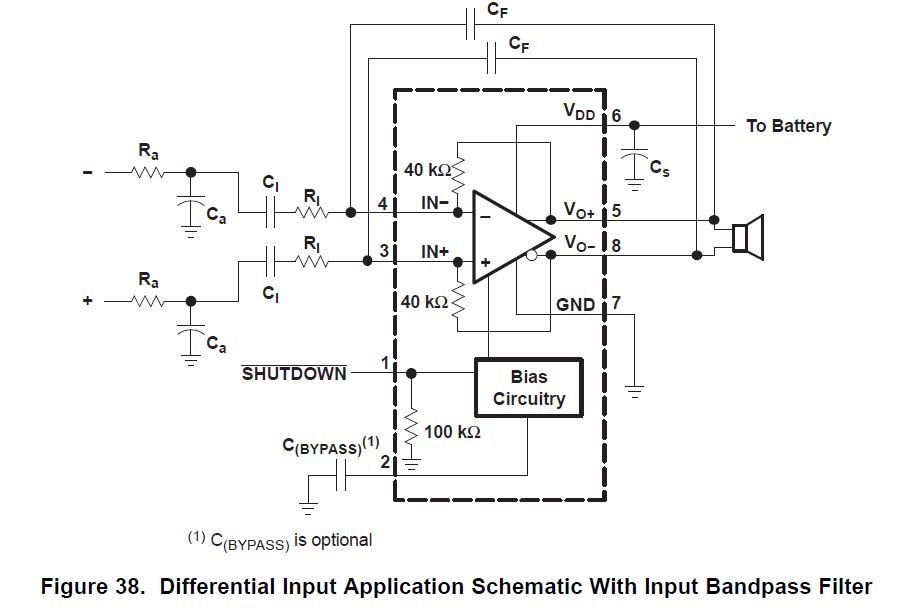

My customer wants to check why we need the CF capacitor here for differencial input. Thank you.

    These capacitors are used to form Band-Bass Filters. These filters are generally used to get a desirable pass-band range. The utilization of these filters depends on your application.
