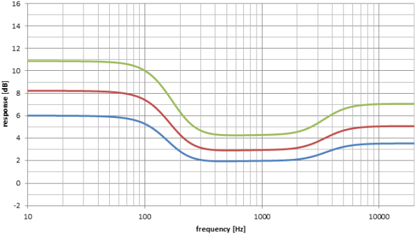

A customer wants to use Loudness component in TLV320AIC3254 miniDSP with same parameter value as it was used in PCM5142 miniDSP. However, frequency characteristics were different between TLV320AIC3254 and PCM5142. I received a question which frequency response was right, from him. So I measured frequency response of both Loudness components, PPS (Portable Audio) and PPS (Home Audio). The results were same as his measurement of two devices, shown as follows.
And I did frequency response simulation by MS-Excel, using default parameter of Loudness component, as follows;
I think PPS (Portable Audio) to be right from the result of my simulation. Then we found that frequency response of PPS (Home Audio) with a half value of Linear_Gain parameter corresponds to PPS (Portable Audio).
I think the scale of PPS (Home Audio) Loudness component Linear_Gain parameter is wrong. How does TI think?

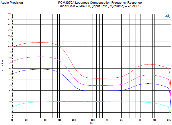

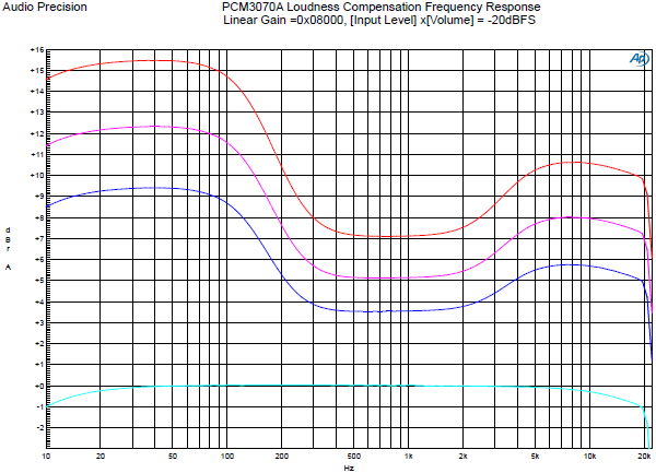

  • Luis-san,

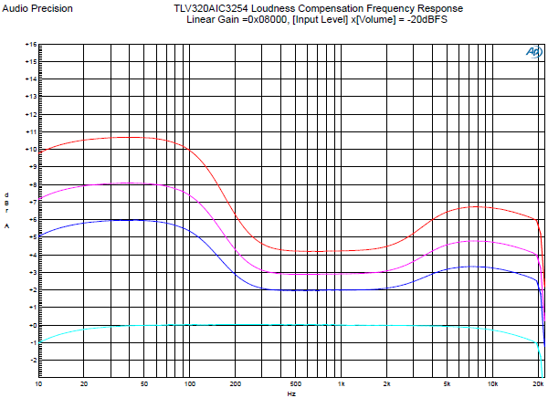

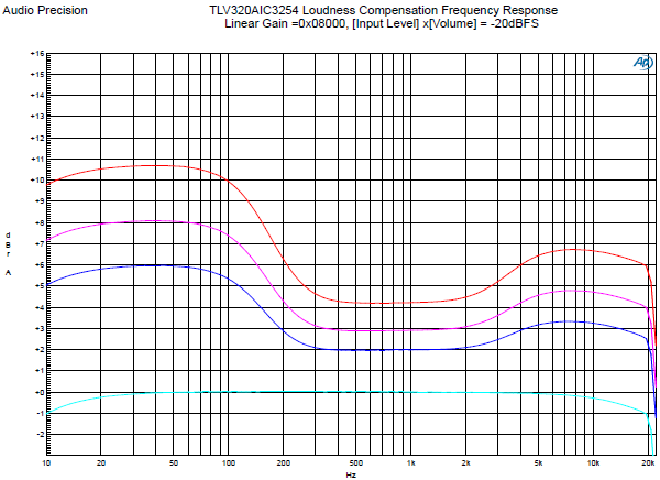

    'TLV320AIC3254 Loudness Compensation Frequency Response' was measured by Audio Precision  when a TLV320AIC3254EVM-K ran on the PPS(Portable Audio) in AIC3254App8x4x Framework, as shown below.
    And 'PCM3070A Loudness Compensation Frequency Response' was measured  when the same TLV320AIC3254EVM-K ran on the PPS(Home Audio) in PCM3070App8x4x Framework, as shown below. Because, we know PCM3070 is a TLV320AIC3254 spin off device. PCM3070 DAC block may be same as it of TLV320AIC3254.
    Therefore, the difference of frequency response does not depend on the kind of device, but on the kind of PPS.
    We have already found a workaround, which Linear_Gain of AIC3254 doubles it of PCM5142. We hope TI to accept this workaround is correct.
    Akio Ito

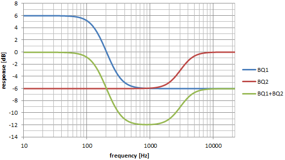

  • Hello, Luis-san,
    I show below the response calculation of default Loudness component.
    Default settings of both Biquad filters are Shelves filter as follows;
    Low frequency gain of shelves filter approaches the DC gain, and high frequency gain approaches the gain of Nyquist Frequency.
    The transfer function of PPS Biquad Filter is;
    (B0 + 2*B1*z^-1 + B2*z^-2)/(1 -2*A1*z^-1 -A2*z^-2)
    in frequency domain
    z^-n -> cos(-n*omega*T) +j*sin(-n*omega*T)
    omega = 2*pi*f, T=1/fs
    at DC
    z^-n = cos(0) +j*sin(0) =1
    DC gain is calculated as follows;
    (B0 +2*B1 +B2)/(1 -2*A1 -A2)
    DC gain of respective Biquad Filter are;
    BQ1_DC_GAIN = (BQ1B0 +2*BQ1B1 +BQ1B2)/(1 -2*BQ1A1 -BQ1A2) =1.9901 (=5.9774 dB)
    BQ2_DC_GAIN = (BQ2B0 +2*BQ2B1 +BQ2B2)/(1 -2*BQ2A1 -BQ2A2) =0.50000 (=-6.0206 dB)
    at Nyquist frequency
    z^-n = cos(-n*pi) +j*sin(-n*pi)
    z^-1 = -1
    z^-2 = 1
    Nyquist frequency gain is calculated as follows;
    (B0 -2*B1 +B2)/(1 +2*A1 -A2)
    BQ1_NQ_GAIN = (BQ1B0 -2*BQ1B1 +BQ1B2)/(1 +2*BQ1A1 -BQ1A2) =0.50000 (=-6.0206 dB)
    BQ2_NQ_GAIN = (BQ2B0 -2*BQ2B1 +BQ2B2)/(1 +2*BQ2A1 -BQ2A2) =0.99763 (=-0.0206 dB)
    Low frequency total Biquad Filter gain is;
    BQ1_DC_GAIN * BQ2_DC_GAIN =0.99504 (=-0.04316 dB)
    Mid range frequency total Biquad Filter gain is;
    BQ1_DC_GAIN * BQ2_NQ_GAIN =0.25000 (=-12.041 dB)
    High frequency total Biquad Filter gain is;
    BQ1_NQ_GAIN * BQ2_NQ_GAIN =0.49882 (=-6.0412 dB)
    according to Loudness Help,
    The loudness gain g is expressed as:
    g = f(volume) = [(volume)^Log_Gain x 2^Log_Offset x Linear_Gain] + Linear_Offset
    if Log_Offset =0, Linear_Offset =0, the results correspond with PPS(Portable Audio).
    g = f(volume) = (volume)^Log_Gain x Linear_Gain
    f(0dB) =(10^(0/20))^Log_Gain x Linear_Gain =1.0000
    f(-10dB) =(10^(-10/20))^Log_Gain x Linear_Gain =1.5849
    f(-20dB) =(10^(-20/20))^Log_Gain x Linear_Gain =2.5119
    Phase can be ignored because of d(gain)/d(omega) is nearly equal to zero.
    at low frequency
    20*log10(f(-20dB)*BQ1_DC_GAIN * BQ2_DC_GAIN +1) =10.88 dB
    20*log10(f(-10dB)*BQ1_DC_GAIN * BQ2_DC_GAIN +1) =8.22 dB
    20*log10(f(0dB)*BQ1_DC_GAIN * BQ2_DC_GAIN +1) =6.00 dB
    at mid range frequency
    20*log10(f(-20dB)*BQ1_NQ_GAIN * BQ2_DC_GAIN +1) =4.23 dB
    20*log10(f(-10dB)*BQ1_NQ_GAIN * BQ2_DC_GAIN +1) =2.90 dB
    20*log10(f(0dB)*BQ1_NQ_GAIN * BQ2_DC_GAIN +1) = 1.94 dB
    at high frequency
    20*log10(f(-20dB)*BQ1_NQ_GAIN * BQ2_NQ_GAIN +1) =7.06 dB
    20*log10(f(-10dB)*BQ1_NQ_GAIN * BQ2_NQ_GAIN +1) =5.06 dB
    20*log10(f(0dB)*BQ1_NQ_GAIN * BQ2_NQ_GAIN +1) =3.52 dB
    if Log_Offset =1, Linear_Offset =0, the results correspond with PPS(Home Audio).
    g = f(volume) = (volume)^Log_Gain x 2 x Linear_Gain
    f(0dB) =(10^(0/20))^Log_Gain x 2 x Linear_Gain =2.0000
    f(-10dB) =(10^(-10/20))^Log_Gain x 2 x Linear_Gain =3.1698
    f(-20dB) =(10^(-20/20))^Log_Gain x 2 x Linear_Gain =5.0238
    at low frequency
    20*log10(f(-20dB)*BQ1_DC_GAIN * BQ2_DC_GAIN +1) =15.56 dB
    20*log10(f(-10dB)*BQ1_DC_GAIN * BQ2_DC_GAIN +1) =12.37 dB
    20*log10(f(0dB)*BQ1_DC_GAIN * BQ2_DC_GAIN +1) =9.51 dB
    20*log10(f(-20dB)*BQ1_NQ_GAIN * BQ2_DC_GAIN +1) =7.07 dB
    20*log10(f(-10dB)*BQ1_NQ_GAIN * BQ2_DC_GAIN +1) =5.07 dB
    20*log10(f(0dB)*BQ1_NQ_GAIN * BQ2_DC_GAIN +1) = 3.52 dB
    at high frequency
    20*log10(f(-20dB)*BQ1_NQ_GAIN * BQ2_NQ_GAIN +1) =10.90 dB
    20*log10(f(-10dB)*BQ1_NQ_GAIN * BQ2_NQ_GAIN +1) =8.24 dB
    20*log10(f(0dB)*BQ1_NQ_GAIN * BQ2_NQ_GAIN +1) =6.01 dB
    Akio Ito

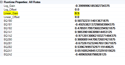

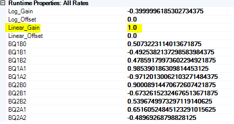

  • Hi, Ito-san,
    Thank you for provide the PurePath Studio process flows. It seems that both loudness blocks have a different linear gain. I recommend to configure the coefficients with the same value. Please take a look at the captures below:
    PCM3070 process flow:
    AIC3254 process flow:
    Luis Fernando Rodríguez S.
