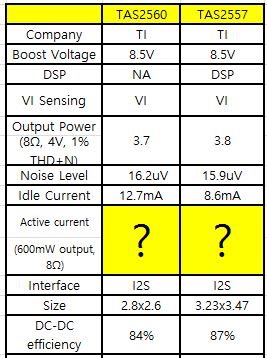

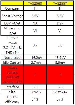

Dear experts,
Customer(Samsung) is surveying audio solution from each vendor.
So they want to get electric spec between TAS2560 and TAS2557 to compare competitor solution.
Would you help me to get the current consumption number(mA) at the condition of 600mW output with 8 ohm load ?
