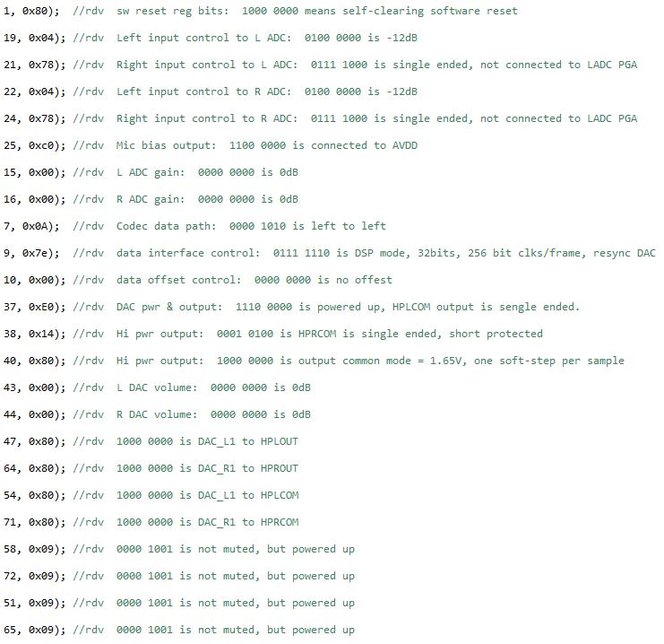

  • Hi Luis,
    Page 0 Register 3 has not been initialized by any code, so it is in its default reset state.
    Here is an image of the initialization code that I found:
    The number to the left of the comma represents the register number and the hex number is the value placed in that register.  All are page 0.  The comments are my notes while deciphering it.
    So, it seems like the PLL is not in use, therefore my settings are correct for using it at a 24kHz sample rate.
    I'll take a look through the app notes you sent.
    Thanks for your help, I think this one is solved.
