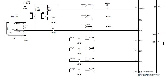

Hi Guys,
I am using TLV320AIC3262 in one of our project to integrate a mic to the codec, in the reference design it is shown a mic with left and right analog input (image1).

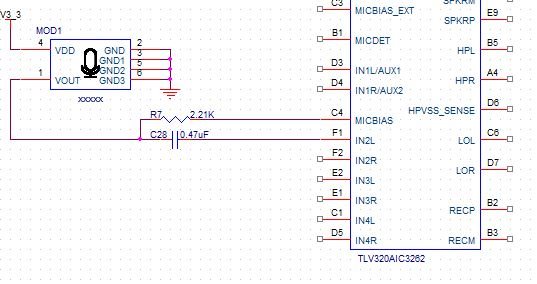

The mic i am using have only one analog output, how can i connect the analog output of mic to the codec? do i have to connect one analog output to both left and right input? (image2) or only have to connect to one of the input? (image3).
