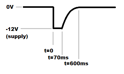

  • When I enable the IC via SD pin, the following POP is seen on both outputs and they are identical. The output goes negative towards rail voltage (in this case 12V). Why does this happen? Should my input resistors be lower e.g. 10k?
    On the scope, my positive probe is connected to R+ (or L+) and the R- is connected to the "GND" of my differential probe.

  • If I reduce the input resistor to 2k (from 47k) then the pop goes from 12V to 5V. And at 1k it goes to 2.5V.. And this is at otherwise open end input. So maybe the input should be around 220R..?

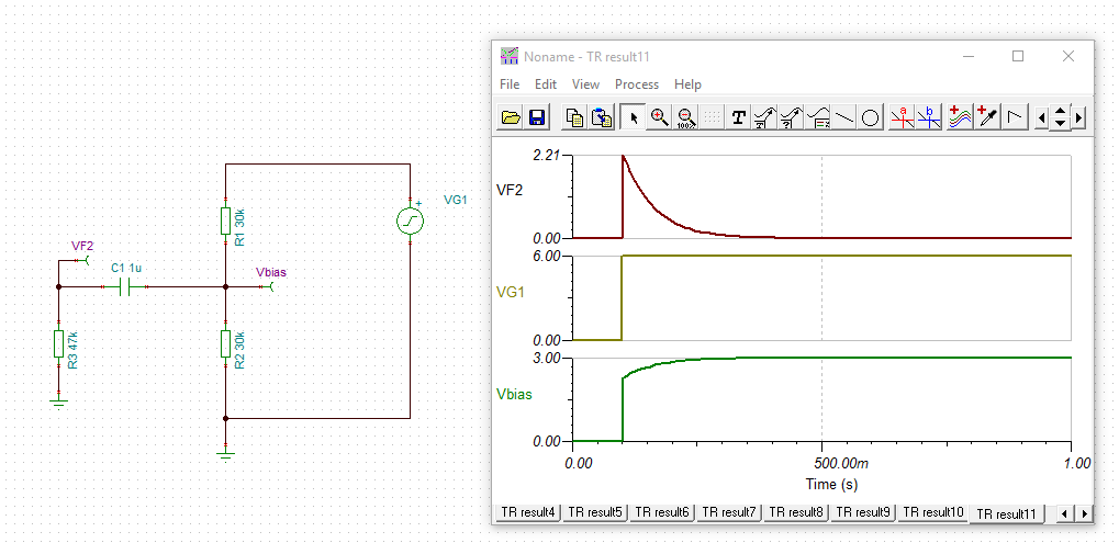

    OK so you believe that the pop is due to the RC of 47k and 1uF while on the negative, there is nothing? And by that, the pop will last until the RC is charged on the P, because it's precharged on the other side of the 1uF (IC side) to about 3V? Thereby we get a difference in impedance and when there is a difference in impedance and the precharge, we will get the pop since the two voltages won't come up at the same speed?
    I thought the 47k would help me to get rid of humming etc. because the output in some occasions was not "loaded"/pulled to GND.
    I'll try to remove the 47k (now 220R) and see what happens :-) More info later.
  • OK.. here's the thing.. As stated, the RC is doing everything bad. If I remove the 47k there is no pop :-)
    I tried to simulate the input stage and by doing that, I can see it's the 47k which is the problem. There is almost no pop with 220R (which I also measured) and I'f I remove (1G Ohm) the resistor, the signal is also OK..
    I then removed the 47k from the PCB and the problem seems to be gone.. wil ltry with speakers attached later, but on the oscilloscope, I didn't see anything popping.
