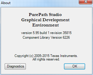

    Could you share the PPS version customer is using?, if the EVM is connected successfully, you should be able to build and generate the code from PPS without issues. A header file can be generated from PPS, please refer to the following wiki for instructions.

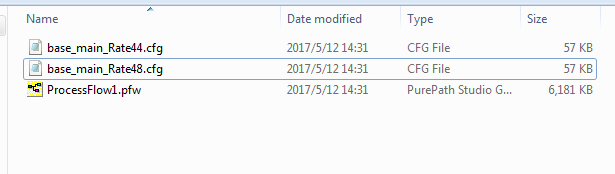

  • Hi Diego,
    Here's what i'm doing. The software version is shown below: Purepath Studio Home audio Minidsp GDE
    Select Open ROM and click on PCM5020 SPDIF ROM COAX.pfw

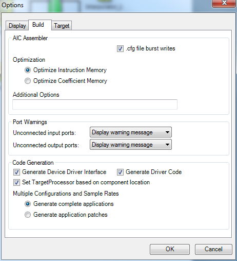

    After editing the EQ and DRC, config the Build options.
    Click Save as and save the file. There's 3 files in the folder.
    Can't generate code because the menu is gray.
    The content of the .cfg file is not correct and can't be used.

  • Hi, Vio,
    Thanks for the feedback. Have you tried to run the ROM code first and then check if it is possible to generate the code?. Unfortunately I don't have an EVM to try this. Also, please refer to the SLAA541 app note for detailed information about the ROM code operation in PurePath Studio.
