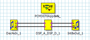

- NOT WORKING: When using the miniDSPs for signal processing, PurePath must be used to generate the required coefficients/instructions for both miniDSP cores, according to the designed process flow. By using the Build->Generate Code option, PPS generates the .h file driver that I append to my MCU code. When booting the PCM3070 code with the PPS code, the codec only outputs a loud noise (not the 60Hz hum noise mentioned in another thread, I'm using a stereo differential output) in both channels.
Here's my simple test process flow:

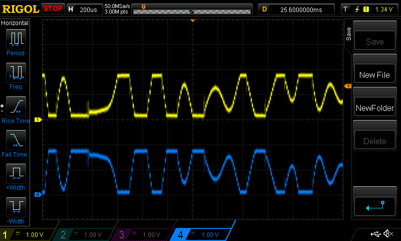

Here's a screenshot of the differential outputs of one channel, centered around a common mode voltage of 0.9V:
I can change the DAC volume (the noise volume), but by testing several register configurations, I can't manage to send proper ADC data to the DAC input when using the miniDSP cores. Thus, Im not able to use PPS to load any desired process flow.

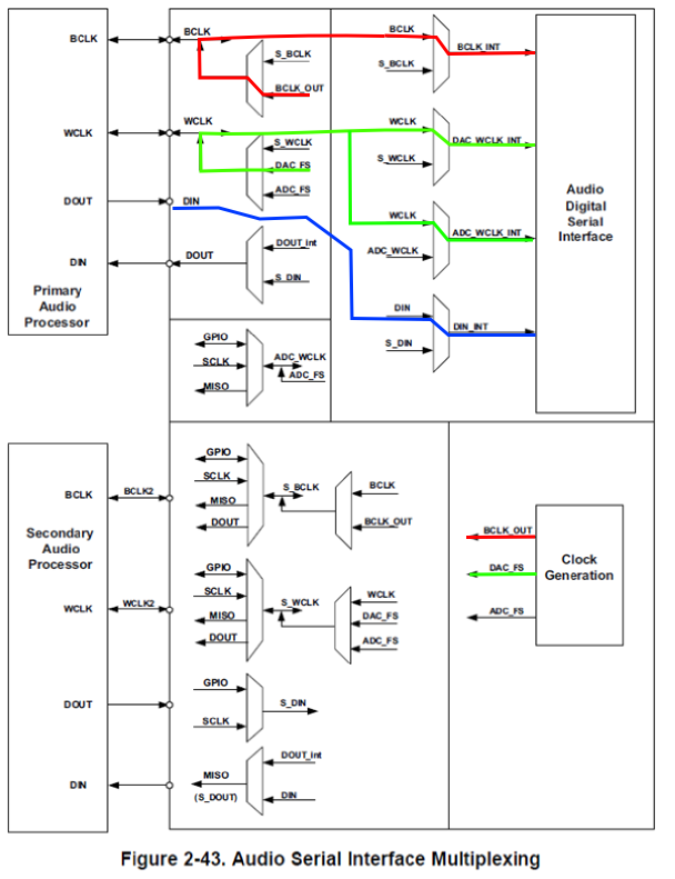

    I also want to say that the Audio Serial Interface Multiplexing scheme (shown in the Application Reference Guide) is confusing to me:
    What I've drawn in colours Red and Green are just regular paths for the Audio Interface colcks. But the blue path multiplexer gives me no option to avoid sending input data to the Audio Digital Serial Interface. In my test application, my goal is to receive the ADC data, process it and send it to the DAC. I don't have an external audio serial data bus. I think it could be some weird configuration missing here.
