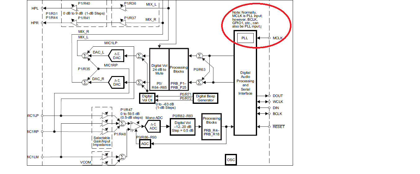

Is it mandatory to Provide MCLK to TLV320AIC3110 Audio Codec ?
As i have seen in Datasheet functional Block diagram of Codec there is note :
Normally, MCLK is PLL input; however, BCLK, GPIO1, etc., can also be PLL input.
But  as I2s signal we already providing BCLK then again why we need to provide MCLK to codec ?
Brijesh.
  • Hi, Brijesh,
    The MCLK is required when the codec works in master mode (BCLK and WCLK as outputs). If the audio codec is configured as slave, the MCLK is not required. However, you need a PLL source in order to generate the internal sampling rate and other clocks. So, if MCLK is not being used, BCLK and GPIO1 can work as PLL clock source.
