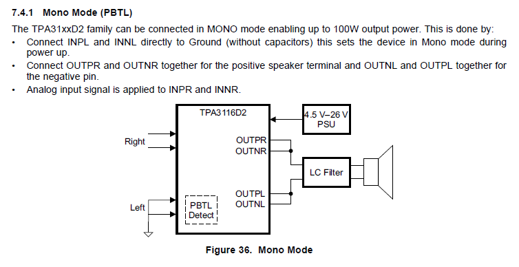

I have a consumer product with the TPA3116 amplifier, which I am very satisfied with, and very nice compactness, it is great!
But it starts to distort a little bit too early so I was hoping I could try the mono mode.
How would I put the TI TPA3116 into mono mode when I got bluetooth, aux or usb sound as input signals?
Hope it is possible.
