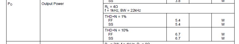

The LM48511 datasheet specifies 5.4W 1% THD+N with 4ohm load, 6.7W 10% THD+N with 4ohm load.

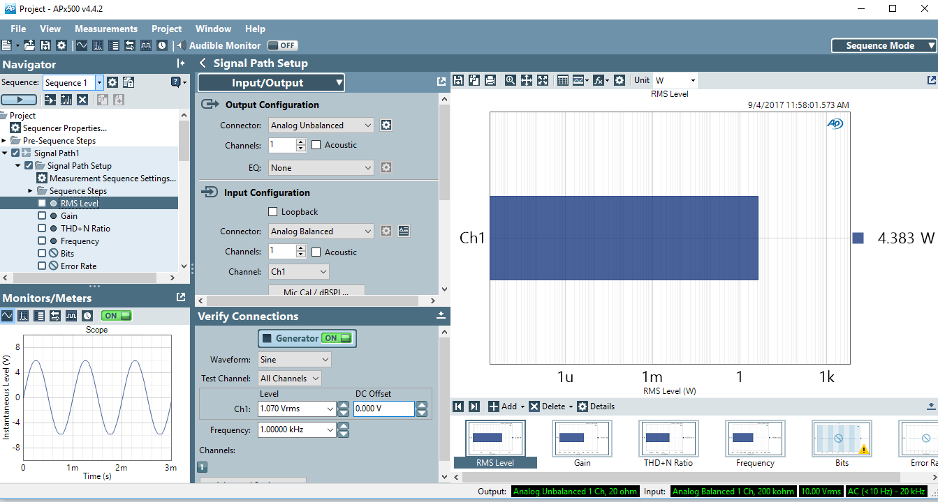

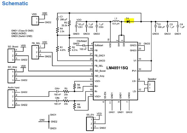

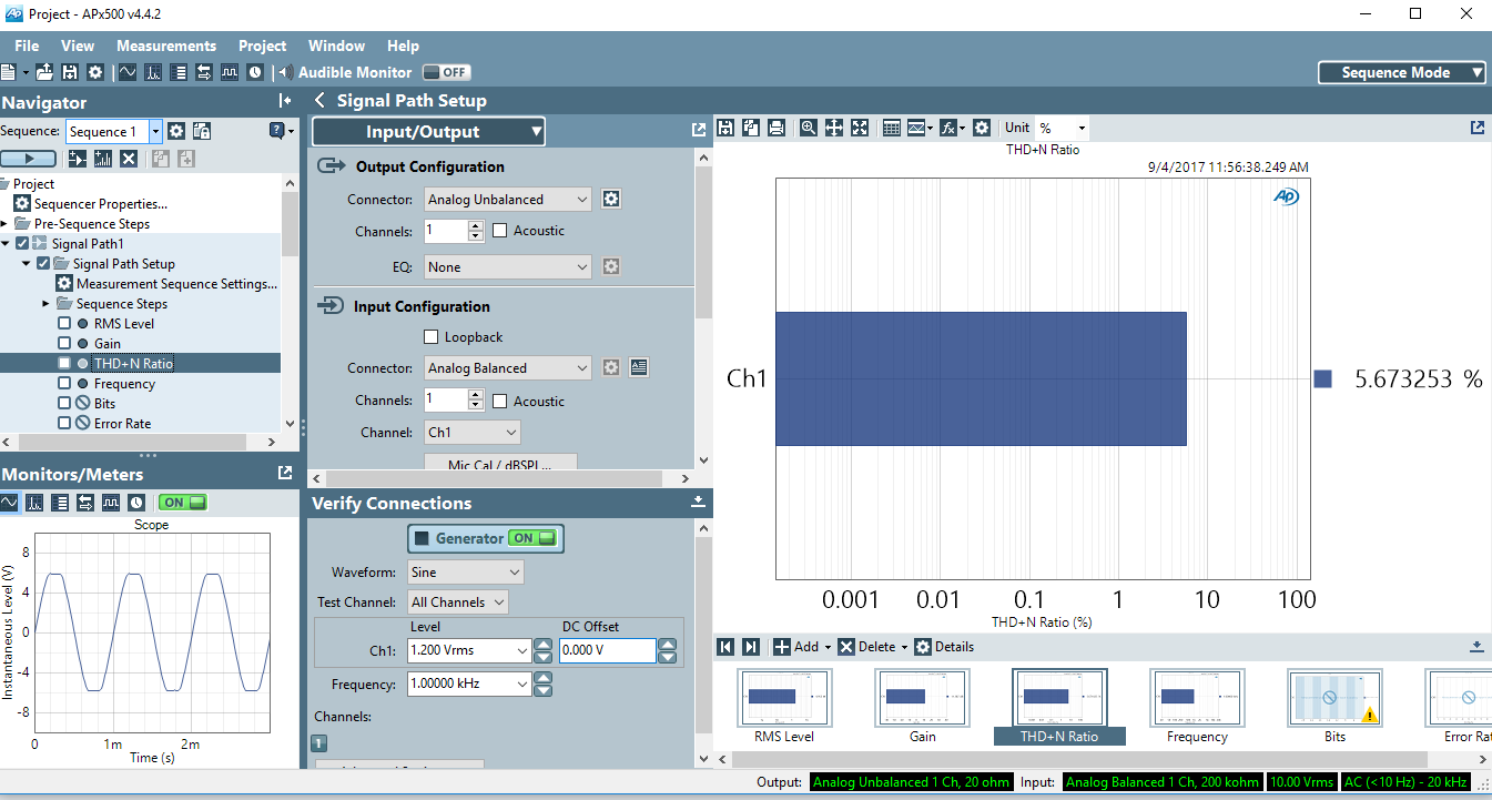

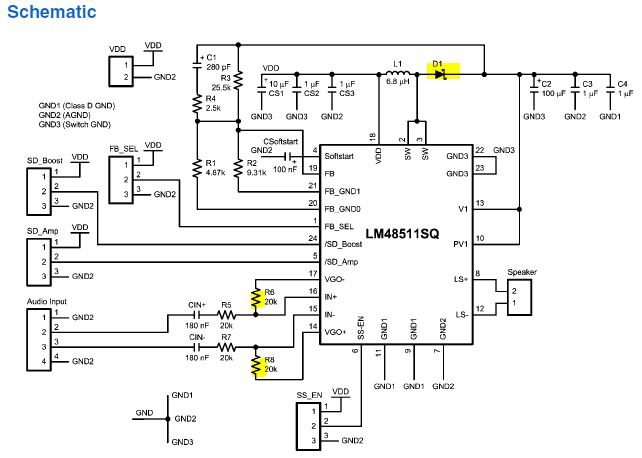

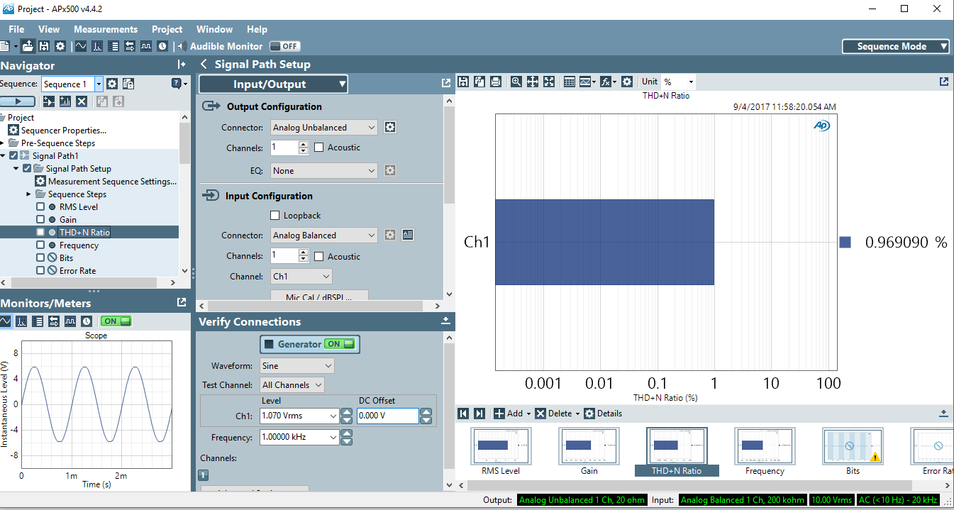

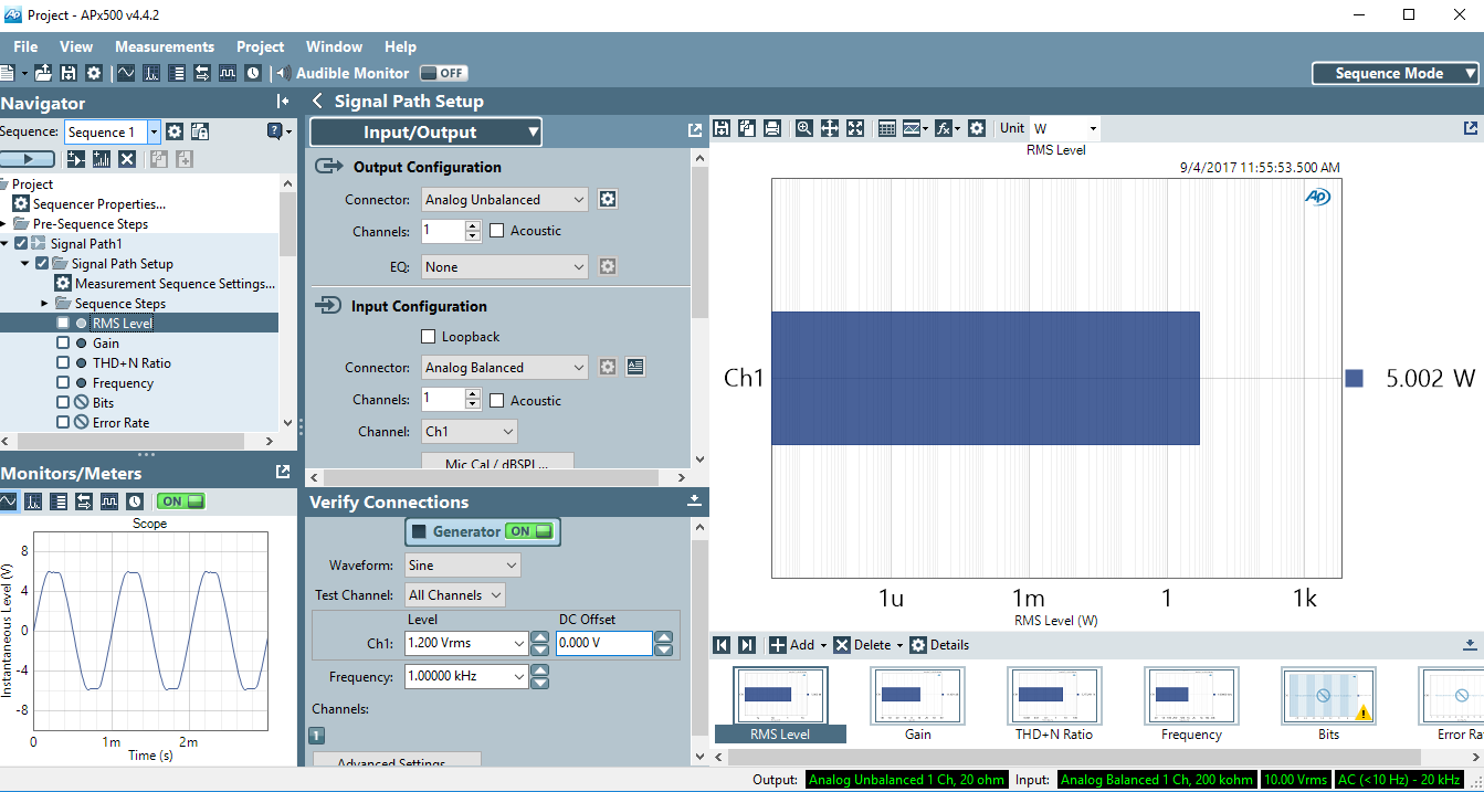

However, we were not able to achieve 5W 1% THD+N on the EVM with 5V power supply. We tried to reduce PV1 voltage drop by changing a 10A Schottky Diodes, increasing R6, R8 to 39kR  to the EVM (picture below), we got 5.002W, 5.67% THD+N, 4.383W, 0.96% THD+N with 4ohm load in the best case.
Would you pls advise the process to reproduce 5W, 4ohm, 1% THD+N on the EVM?
