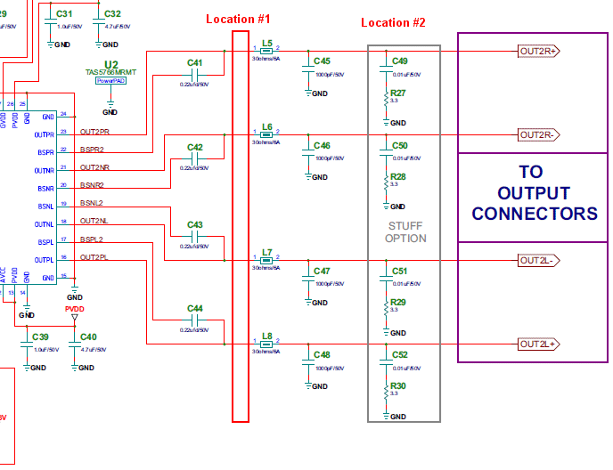

Hi Sirs,
With ferrite bead design (no RC filter) with the TAS5766M, should we place the RC snubber before (location #1) or after (location #2) the ferrite beads? Which location is better? How can we adjust the RC snubber values for EMI suppression?
