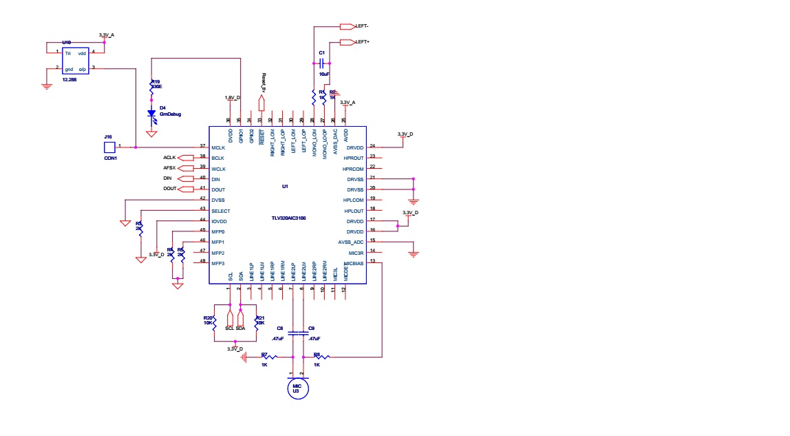

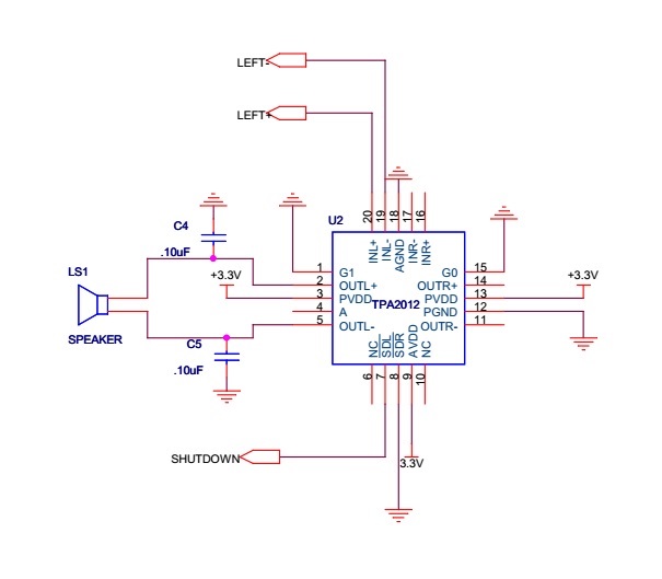

I am using TLV320AIC3106 with CC3200. Microphone configuration is completed and I am getting data out from the CODEC IC through I2S. Now I am need to out this data to speaker to validate the microphone input. What are the configuration needed for doing that?
This is the microphone configuration.

Below is the schematic attached.

    Basically, if you are willing just to playback the mic input through the speaker output, you can configure the LINE2L Bypass [Reg 40] and then select LINE2L as the source for the MONO_LOP output [Reg  73].

  • Hi, Vishnu,
    Thanks for the feedback. In order to configure the DAC  as the source of the MONO_LOP output, you need to configure either Registers 75 or 78, according to the DAC channel.

  • Hi, Vishnu,
    Thanks for the feedback. The Mono Line Output seems to be correctly routed, however, it seems the output driver block is not turned ON. Please configure register 79 to unmute and turn ON MONO_LOP/M by writing a 0x09 to reg. 79.  (note that bit D0 should be R/W).

  • Hi Diego,
    Thanks for the response. I've configured register 79 also with 0x0B value and still no result! I'll take a look into the circuit and check again.
