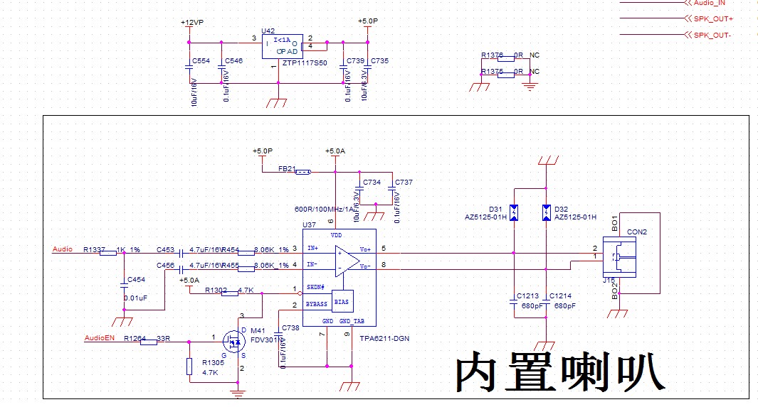

Hi team,
My customer is using the TPA6211A now, and find the shutdown pin is broken, Could you please help double check the schematic below? Thanks.
BR
Frank
