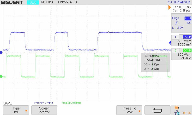

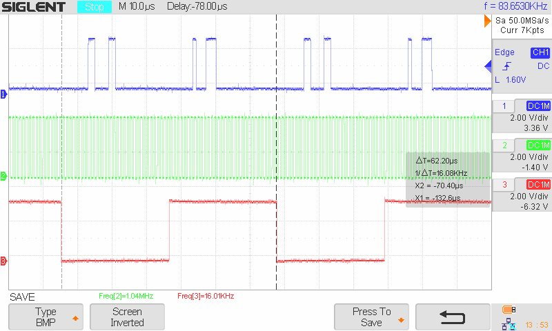

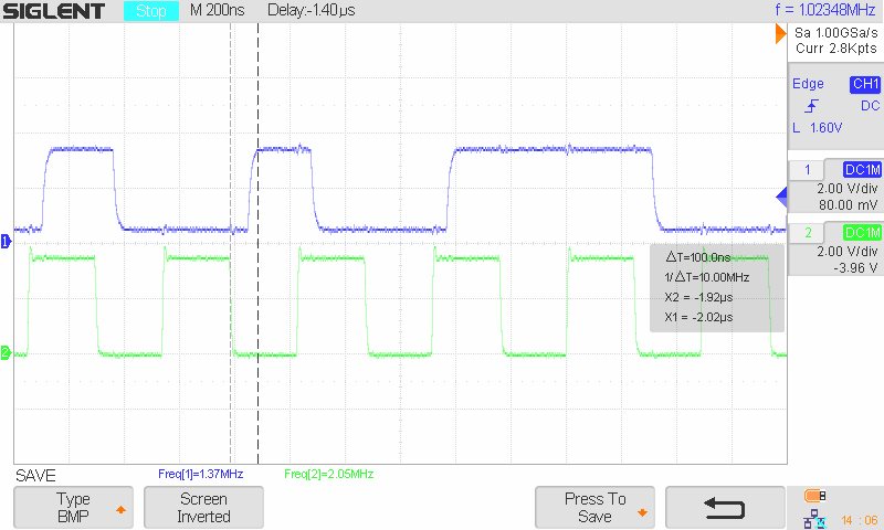

    I measured the frequency of all clocks (see first attached image):
    BCLK=1024khz (green)
    WCLK=16kHz   (red)
    Microphone Clk=2048kHz
    MCLK is not used.
    I2S Data Stream with 2 times the same value for left and right channel  (blue).
    The second attached image shows the PDM-Data signal (blue) and Microphone CLK.(green) and the cursers show the delay between them (max. approx. 100ns).
