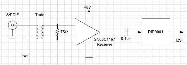

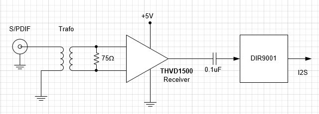

DIR9001: Question of the DIR9001 Design Block Diagram
Dear Wayne,
AES3 standard follows the RS-422 electrical characteristics. You can use any RS-422 receiver which will take in a differential signal and convert it to a single ended signal.
