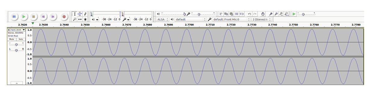

    After aic3268 driver implemented in our custom board, I have tried to record(use alsa utility "arecord") full-scale stereo pcm data via audio interface of aic3268(AS1).:
    - The analog input signals are 1KHz sine wave on IN2L and IN1R pin.
    - The input impedances of IN2L and IN1R are 10K ohm.
    - The input common mode(CM) is 0.9V

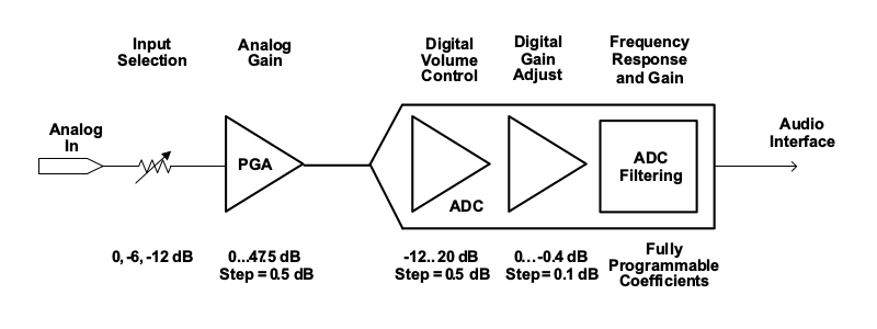

    - All gains are zero.(I have checked analog gain, digital volume control, digital gain adjust as shown below)

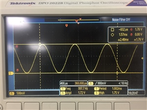

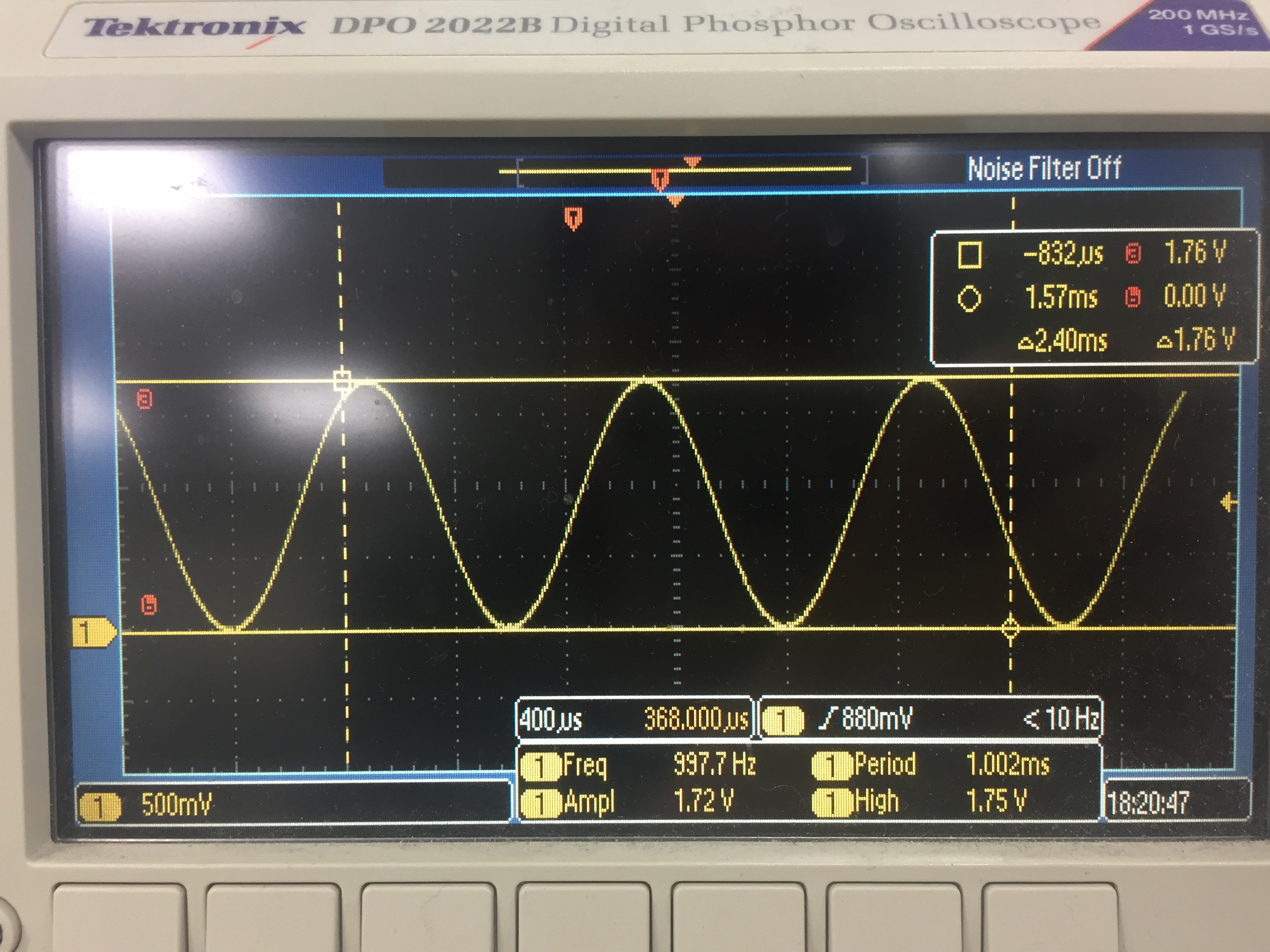

    It is strange that input level must up to 1.76~1.8Vpp(about 0.63Vrms not 0.5Vrms) to achieve full-scale in the digital pcm domain.
    Are there something wrong?! or is it a tolerance?
    The analog signal on IN2L by an oscilloscope:
    The digital pcm data opened via audacity application:
    Thanks!
