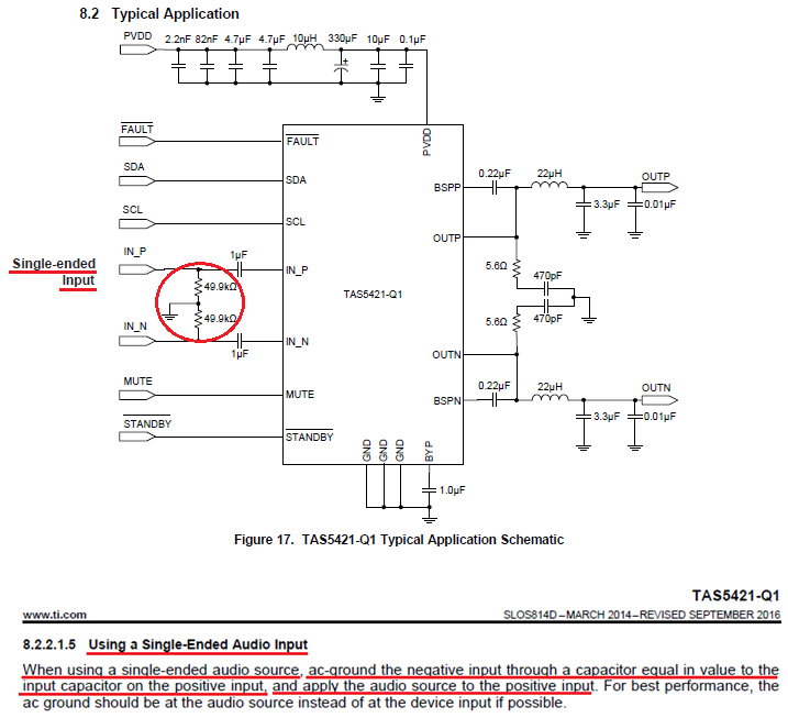

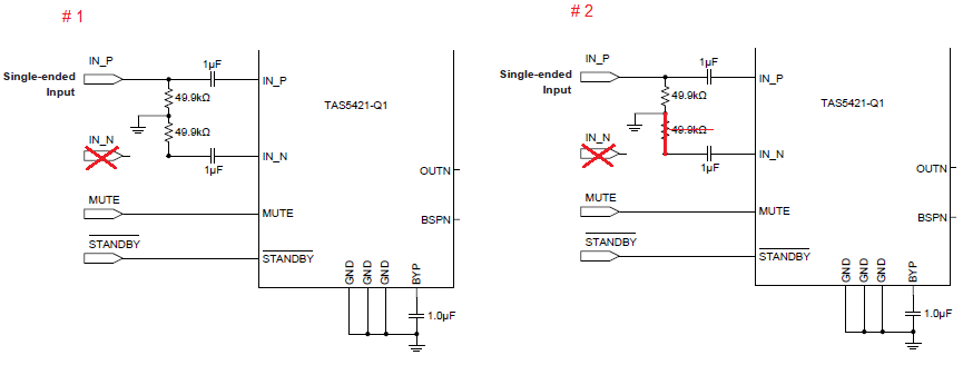

TAS5421-Q1: How to handle the 49.9kohm resistors when configuring single-ended input
Part Number: TAS5421-Q1
Hello Audio team,
My customer will change the input configuration of TAS5421-Q1 from differential to single-ended, but asked how to handle the 49.9kohm resistors in the typical application schematic of  TAS5421-Q1 datasheet when configuring single-ended input. Please comments on this question.
