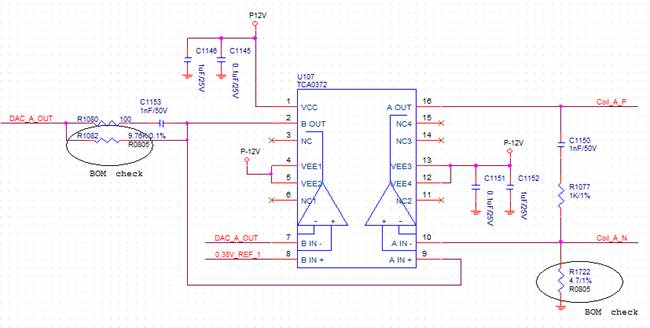

Dear all,
Could we use LM1877 to replacement the TCA0372 or not?
If not, could you suggest more suitable IC to us?
The circuit as below,
Thanks!
  • Hi Julian Chen,
    This device could be replaced by the LM1877.

  • Hi Julian,
    As Jose mentioned, this looks feasible. But you need to know that this is a very old device, so the support for it will be limited. Please recommed our customers to use our class-d device(e.g. TPA3137D2, TPA3111D1).

  • Dear José Luis Figueroa,
    Thanks for your reply.
    Could you let me know the description of bias pin?
    In this case, should I use bias pin?
    Thanks!
  • Julian,
    The bias pin should be connected to a capacitor of 50uF and it should be tied to GND according to with the datasheet.
    I think that this capacitor is like a bypass capacitor. The bypass capacitors handle starting-up time of the device and reduce noise produced by the power supply.
    Unfortunately, as Shawn mentioned is a very old device and the support for this device will be limited.
