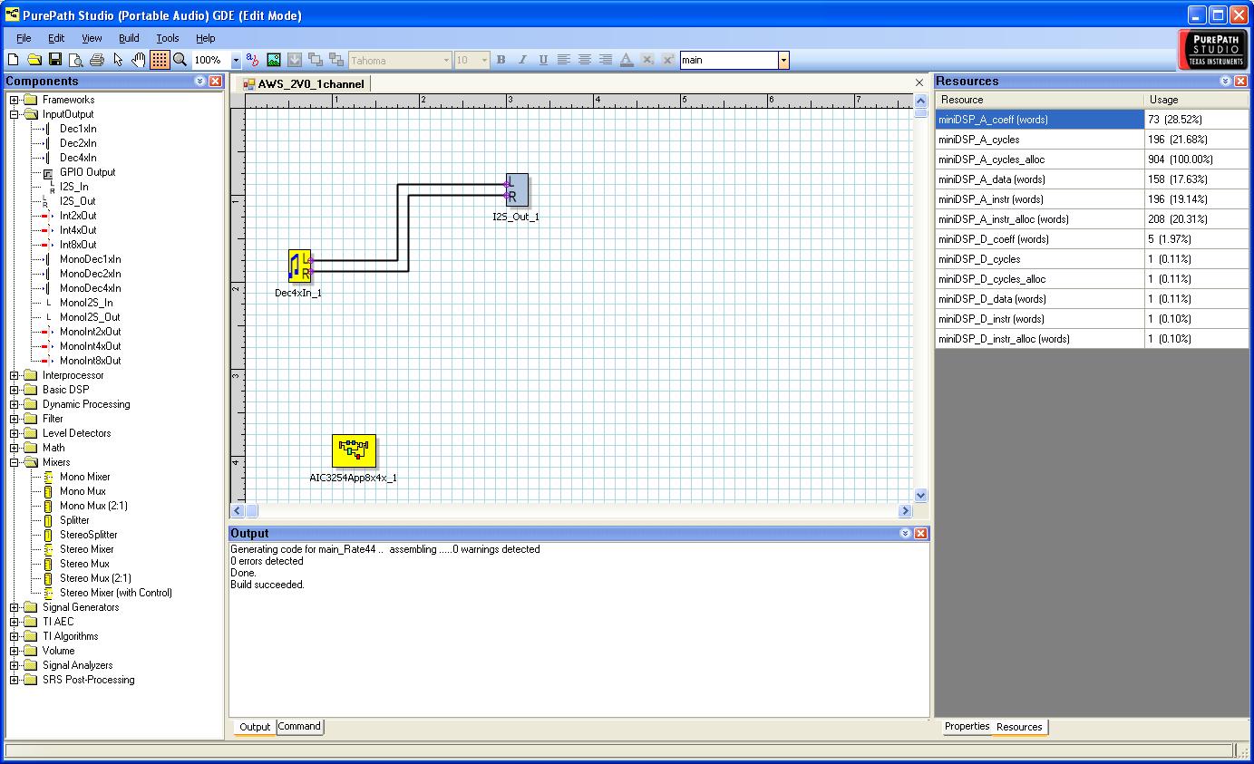

As I need to treat the audio stream before transmitting it through I2C I tried to activate the DSP_A. I created a project with nothing else than the I2S interface. Since then the MCU is receiving completely different values which might still be related to an audio signal but are nothing like before. Amplitude is much too high and there are always a few values consecutive with the exact same value. As well the headphones are not working anymore. Only unequal noise comes out of the left and right channel.
I program the CODEC as followed:
- program 'REG_Section_program' from generated .h-file
- program 'miniDSP_A_reg_values' from generated .h-file
- program 'miniDSP_D_reg_values' from generated .h-file
- program 'custom_program' (manually written script)
I would assume that by putting my script at the end that the CODEC should work similar as with only 'custom_program' with the exception that now the DSP part is loaded and used. I cannot understand why this automatic generated script is affecting the previously working script.
