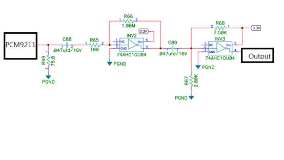

Dear Sir,
Thanks you for your support.
May I use the circuit as below for driver?
