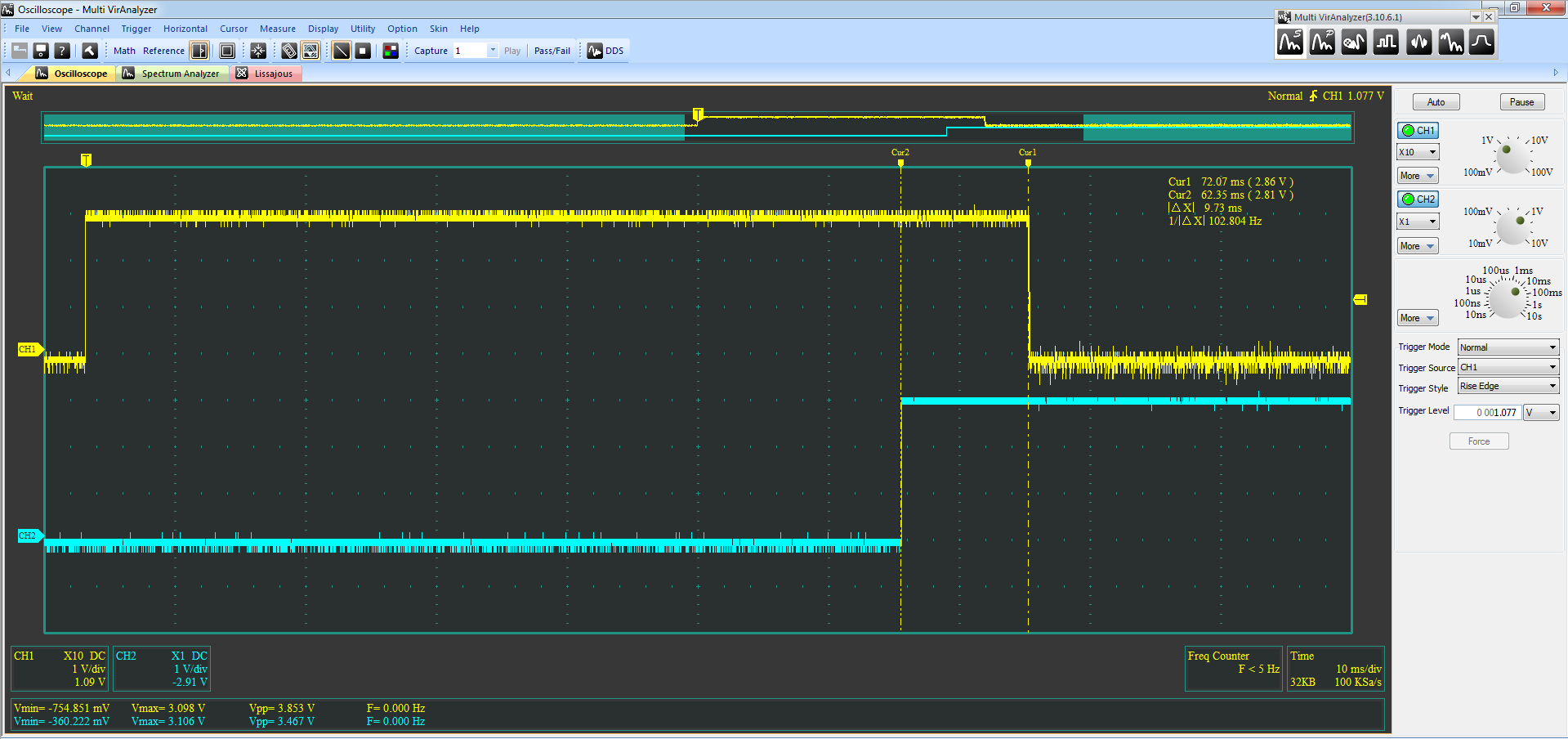

Thi components is used in a dac capable to play pcm and native dsd files, switching between the two by means of a series of multiplexers connecting the 4 I2S input of the pcm1795 to the proper signal sources.
The  schematic of principle is the following:
The older version was implemented with sparse logic, but currently it is realized with a CPLD.

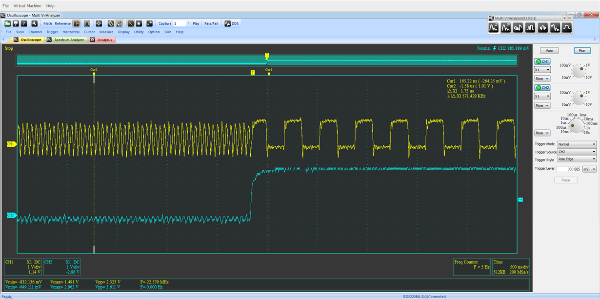

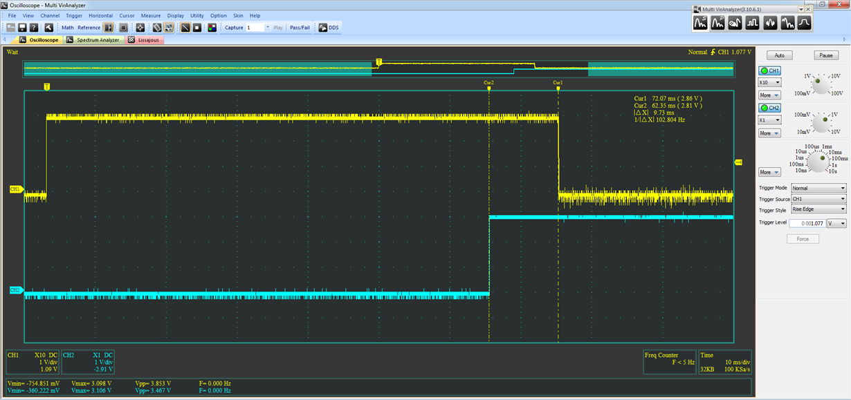

My problem is the commutation from PCM to DSD: in almost of 50% of cases, the dac starts bad, in the sense that the music is distorted and a big rustele is audible. What I have to do, at this point, is to commute to PCM then back to DSD, hoping that this time noise does not appear.
I did a lot of tries in order to eliminate this problem; commutate I2S before setting the bit DSD of register 0x14, after that and simultaneously by detecting the spi register sent to the pcm1795: no results.
What is wrong in my way to proceede? Do you have any suggestion on how to commutate from one mode to the other?
